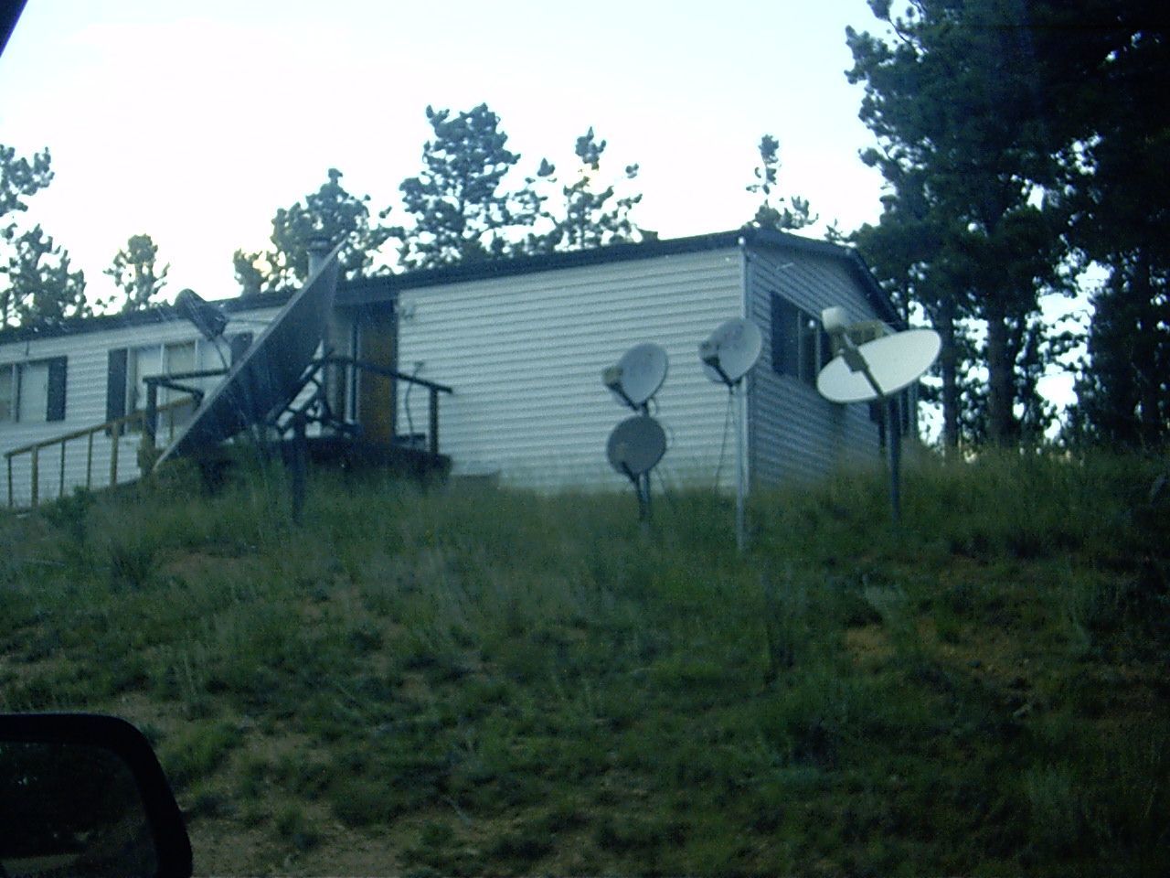

Oh - and I tell the customers "I would not put something on someone elses home that I would not do to my own" too - just lke my pics, which don't show the THREE dishes up on the roofline.

You mean like my neighbor's place? :D BTW, us mountain folk don't consider dishes unattractive. ;)
