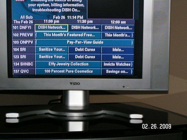

PICT0001.JPG guide shows locals missing 4,5,7,9,13 etc. all sub'ed too.

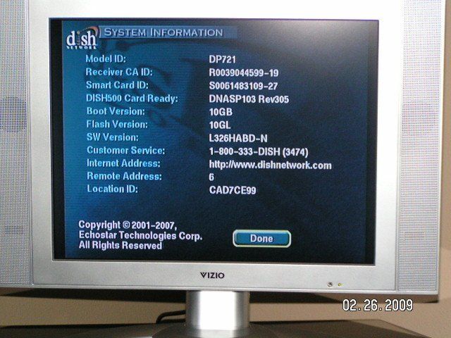

PICT0002.JPG system id info

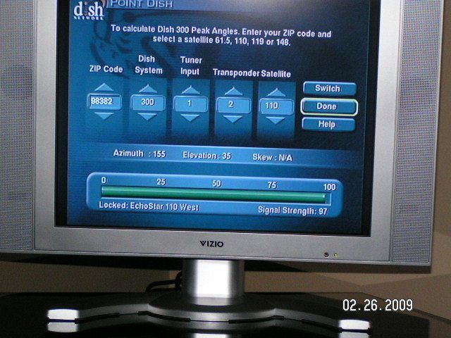

PICT0003.JPG signal strength

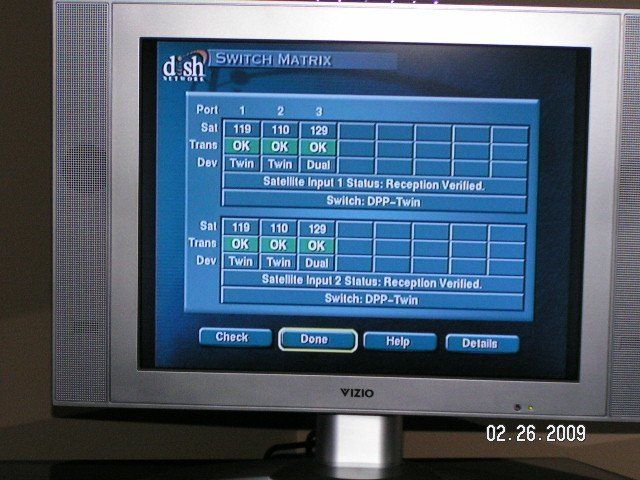

PICT0004.JPG switch matrix

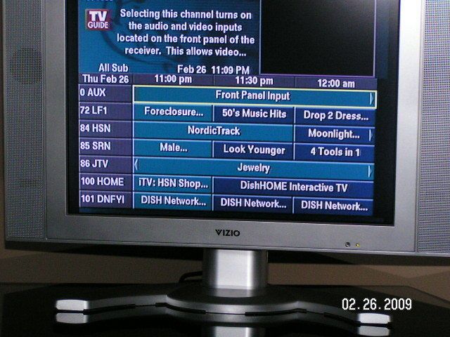

PICT0005.JPG guide missing 110,111,112 and other sub'ed channels
When I try to select a channel listed in the guide, I only get a blank screen, except channel 101.

It's a card - too old revision '305'. Should be higher around 308 or 30A ( hope some lucky owners of working 721 will shime here with proper revision number). I would pressurize Dish to send you new one ( perhaps DNASP260 ).
