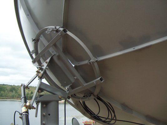

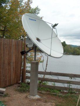

Here is a couple of pictures of the FortecStar adapted from the
ground stand to a much better motorized solution.
I did read they were working on something like that.
Its just 1" square tubing, welded to fit the FortecStar ring, and bolted
on.

Nice! I'm sure quite a few Fortec owners will be inspired!
Is that the Channelmaster mount that the 1.2M guys are using?
Yes it is the same mount, however it did need a small adjustment
for the prime focus dish, the elevation was not adjustable enough.
Pretty easy mount to work with though, and it is very nicely built.
