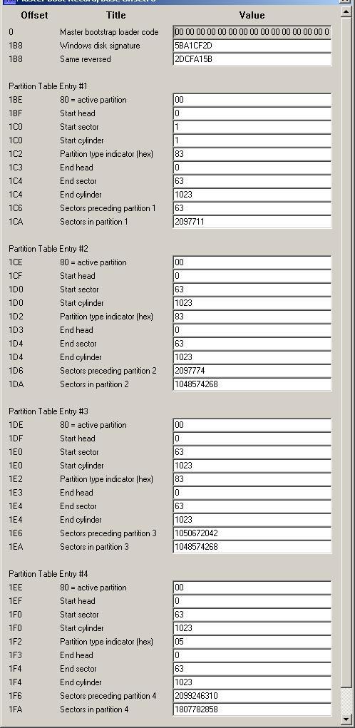

It did formatting, but after reboot 622 shows 1 GB free space available.
There are created three formatted EX3 partitions: 1 GB, 500 GB (DishArc), 500 GB (DishArc) and one extended 862 GB, but empty - no file system.

Could you use a utility and re-size the (2) "storage" partitions and see how the DVR reacts to them ?
Well,your report doesn't provide any technical info.
Would you run any partitioning software what support EXT2/EXT3 and post the scheme here ?
I'm suggest those 1.5 TB have same two 500 GB DishArc partitions.
[Actually, I could buy 1.5 GB to try reveal the facts too.]
Dish SW is very picky about sizing or touching partitions or dir/files - usually if you change something it will rebuild whole disk from scratch.
