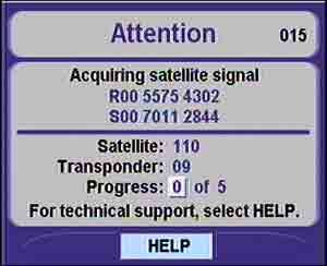

I don't have a 2nd receiver. I have done the check switch and reboot without any change. I am going to take a signal meter out to the dish this weekend to see if I am getting it there.
The check switch shows that the LNB on the 1000+ is connected but no signal where 129 should be.
