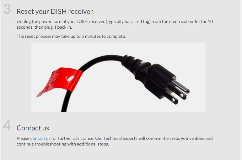

I had her pull the power cord for a few minutes which didn't resolve it.

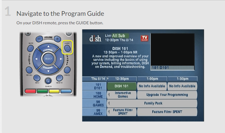

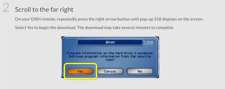

I couldn't say for sure. These steps can force the guide to update. If it doesn't the receiver probably will need to be replaced.
