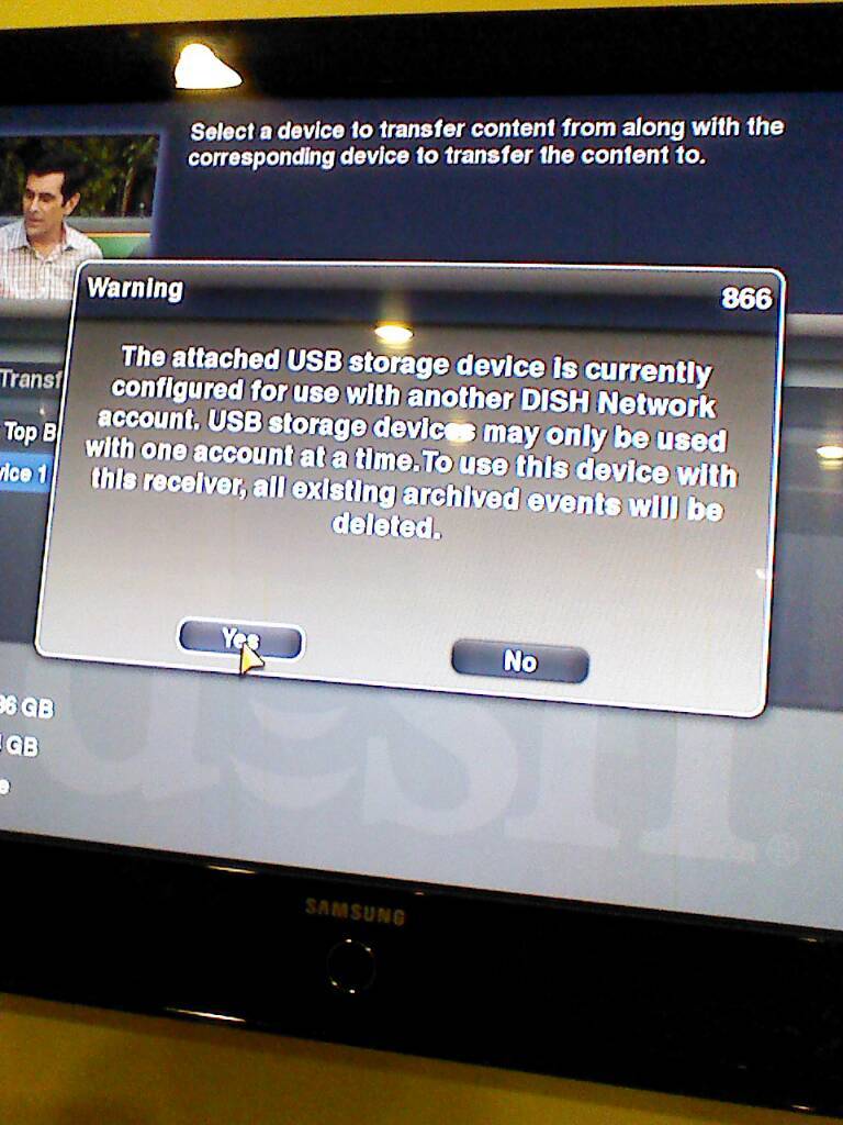

Okay I got my recordings transfered to the ehd just fine. Got the hopper installed today, but when I hook it up and try to access it, it says it cannot be used with more than one receiver and you will lose all archived recordings.
Am I doing something wrong?

Here is a screen shot.
Sent from my Nexus 7 using Tapatalk HD

Unfortunately Mary was not able to help. If anyone else has a possible solution, please let me know. I also tried the dish chat support and they said they would forward it to someone, but I would not be contacted if it was ever fixed. I guess I'm sol.

This is not making sense. Did you change your account number when upgrading to the Hopper?
No, not that I know of. I did have to go through the retention department to avoid paying out the nose. But I never discontinued service.
Yeah. Lucky86 and I are trying to understand how this can be, because many folks have already upgraded from the VIP line of DVRs to a Hopper and encountered no such EHD problem. At least not recently... :(
