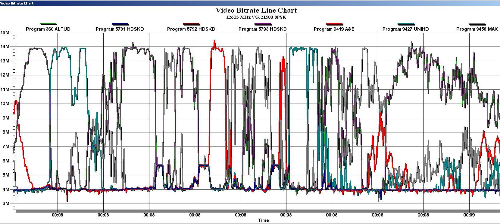

Back to the original topic, there are major issues with 129W TP27. When Dish added the HD sports channels, they decreased the quality on the 3 existing HD channels (MAXHD, A&E, and Universal HD). Apparently they set the minimum bitrate for the sports channesl to 4Mbps. Unfortunately, this really hurts when there is no game playing and all the channel is showing is the "DishHD" logo. As you can see from the graph I have attached, no channel dips below 4Mbps.
There are 6 actual video pids on this transponder (even though there are 7 listed on that graph). If you notice, Altud and 5793 HDSKD are graphed the same (green and purple) because they are mapped to the same video pid. When I captured this data there was a DishHD slate on 5791 and 5792. These two channels are eating up 8+Mbps from this mux!!!! That is approx 20% of the mux devoted to DishHD slates!
It is also obvious that they have a 14Mbps rate cap on each individual channel. Keep in mind all 6 video pids are h.264 so we can't really relate to mpeg2 bitrates. The chart captured the real time bitrates of the pids on that mux for approx 1 minute.

Wow!! excellent graph!! I wish I knew what the heck I was looking at!!! So are you are saying that Dish added a sports channel and 129/27 took a dump? Which channel and when?
Sorry for my ignorance, I have no idea WTF a PID and a MUX are. I need to do more research!
Do you have that graph for say a 24 hour period? I've noticed the bulk of my signal loss is an afternoon event.
Is there a graph which shows the 3 existing channels before the addition of the 3 HD Sports source channels? If not, the actual effect of adding the channels is not known.
If the slates were to use next to no bandwidth, there would be a substantial change in the existing channels when a sports event began and a noticeable change would occur. This noticeable change is to be avoided. Thus, the slates do use an appreciable amount of bandwidth, while not being as much as a sporting event would use, the change is minimized.
Based on other MPEG4 Tps, we should expect this Tp to have 6 HD channels and accept the PQ that results from that loading as that seems to be what they plan to do throughout the system. The reaction to the first Tp which had 6 MPEG4 HD channels was positive.
There is a difference in the setup of this Tp versus the other HD RSN Tp. This Tp can have 6 active channels while the other HD RSN Tp is configured with 5 active channels and apparently one slate channel. Perhaps Hokie Engineer or digiblur can confirm if there is a channel on Tp 8 which has no SID(perhaps VPID 7714).

They appear to be in the process of adding local sports HD channels to that tranponder. I wouldn't expect the quality to increase. If you are having signal issues, that would be caused by either your dish not being pointed perfectly or a lnb issue. I'll check the signal levels on 129 to see if TP27 is lower than the others when I get back home.
A mux is a group of data streams. Each stream could be a video, audio, or data channel. I found a great place to start reading and learning this stuff is on this webpage:
North American MPEG-2 Information
John:
You probably are correct that they were planning on 6 channels from the start and were already doing some rate shaping on the original three channels. I don't have any data from before this change was made :(. If you look at my graph from 61.5, you'll notice max-hd peaks out much more than on 129. The nulls on the 61.5 tp make me think they are planning for 6 channels on that mux as well.
