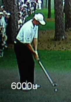

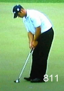

I'm still suffering through the wavy lines. I actually called Dish after hooking my 6000u back up and noticed a better picture. They, of course, have no clue what I am talking about but did send a note to the technical team not that that will do me any good. BTW, my TV is a Toshiba Theaterview TZ55X71.
I took a couple of pictures of the Master's tournament to illustrate what I'm am experiancing. These pics were taken using an old 1 megapixal camera so the quality isn't that great but you can get an idea of what I am seeing by looking at the club in each picture.

After looking at your pictures it is quite apparent that you do have a problem.
I wish I could have an answer.
My guess is that if you can not resolve this with the various adjustments available on the 811 and/or you TV, then perhaps the 811 is defective.
I have never had anything similar with my 811 and my 32inch Toshiba tube HDTV. I did have one problem once where I tried to move the picture to be better centered on the TV and all hell broke loose until I returned to the factory settings.
It's times like these when it would be nice to have a friend with a similar product that could be substituted to see what would happen with a different, know good unit.
In essence you have almost done this by putting in the 6000 but would be even better if you could take the 811 to a friends house and try it there.
My guess is that if you can't adjust it to eliminate the problem then the 811 will probably have to be replaced.
Good luck.............

What I see is Edge enhancement from the broadcast inducing the ringing shadow. Make sure your SVM is disabled. Some Toshibas have an off switch other have to be mechanically disabled. http://www.keohi.com/keohihdtv/brandspecific/toshiba/generaltweaks/generaltweaks.html
The stepping of the shaft is due to poor 3:2 pulldown.. Now the picture does not look HD either. Not all the cameras used were.
Those that are seeing horizontal lines probaly need to turn down the contrast/brightness. Using a HT set up disk like AVIA/ DVE or Sound and Vision to properly set contrastbrightness and color levels among others.
If the this does not clear it up the last possibilitie that comes to mind is poor shielding on either a speaker or a cble.

I turned off the SVM settings according to the Keohi web site instructions and watched Ice Age on HBO last night. It looked great. I still need to use the THX setup disk but at least one step made an improvement. I did switch the 811 to the 16x9 setting but I could not see the entire "wide" picture when doing that so I switched it back to the 4x3 #2. Plus I saw no change in the picture quality of what was viewable.
