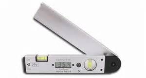

Do you have a way to measure the elevation and declination of your dish to make sure they are set correctly? angle meter.jpg
