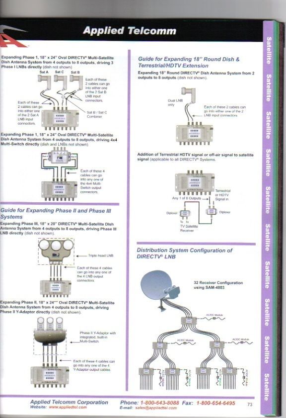

Ive used a zinwell 4x8 multiswitch to run 24 ird's from dtv for a local sports bar part #sam-4803 from applied telcomm or any local satellite parts store dlsus.com has this switch on sale for 34.99 each
