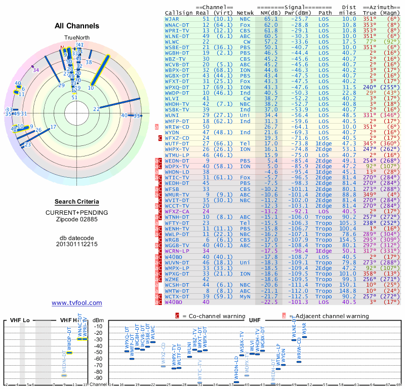

You're really handicapping your reception by putting it on the side of the house. I used TVfool and put in 10 ft above ground level. Everything LOS should be receivable with a UHF antenna, I would suggest a 2 bay UHF bowtie. I use an Eagle Aspen Pro Brand DTV2BUHF $29.99 from Solid Signal at 67 miles from Dallas and you are looking at stations about 40 miles distant. If you do a google search for that antenna I found starting prices of $14.99. Warren, RI shows that you are looking virtually through the entire state to get those Boston stations you really need as much elevation as you can get. There have got to be a lot of tall buildings between you and the broadcasters.

Actually, if one of the sides of his house faces north, it might be doable. All of the Boston stations are about 40 miles away.

If you're looking at Radio Shack, you may as well start out cheap, look at the AntennaCraft AC9 ($18.95). It's only rated at about 25 miles, but it appears many of the stations are LOS (line of sight) - although I'm not sure the TVFool report shown by ckhalil18 is anywhere close to your exact address, it was probably generated by your zip code.

First thing for you to do is run a TVFool.com assessment using your EXACT address, maybe even going to the TVFool mapping facility and finding your house on the satellite map and entering the exact height you will be putting the antenna - this will give you a better picture of your challenges, which do not appear to be many.
Looks like you are somewhere around Warren DE. The terrain is not challenging between you and the Boston towers, since you are getting them on your indoor antenna, almost anything outdoors should work. decide how much you want to spend and buy accordingly.
