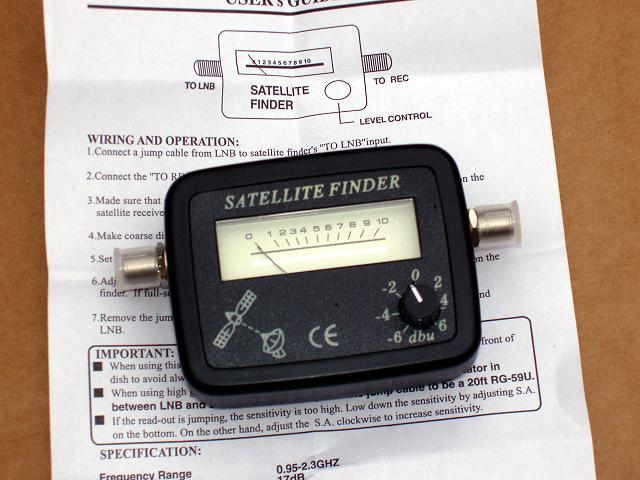

I found out that you can connect a cheap little squealy meter to an lnb and just holding it in your hand, not on a dish at all, point it in the sky in the general direction of a satellite and if it's good, the squealy meter will squeal. Move your hand in front of it a few time and the signal stops when you do. All you have to do is send power to the thing, I've used my birddog meter as a power supply just to run the squealy meter (since the birddog rarely works on FTA anyway).
I realize this is not really testing it to see if it will get tv but it tells you if it's dead or alive and you can quickly decide to toss it or test it further.
Dee_Ann,
That is probably the BEST QUICK method I have heard of or read of to test an LNBF! Really slick!
RADAR
That is how I have been testing the lnb's for years to see if they work, waving the hand over them and reading a higher signal meter reading. I realized this would work when the signal meter read a higher reading when it was towards the trees. That is one thing that sucks about meters, they read higher when going towards the trees.
