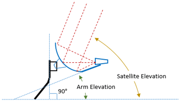

Utilize an inclinometer or angle measuring app on a phone. These are typically accurate to 1/10th of a degree.
Determine by measuring the angle the LNB arm makes with the horizontal plane when aimed at your southernmost satellite. This is how to measure for any satellite elevation for an installation. The angle measurement stamped on mounting brackets can be confusing or just plain wrong. Say your LNB arm is at 30° when you are aimed at the southernmost sat that is at a satellite elevation or 45°, you set the LNB arm to the angle equal to "Sat Elevation" minus 15°. Just measure one time to figure the correlation of a specific dish's LNB arm angle to the aiming elevation angle. I like to write this angle on the dish with a sharpie so I have it anytime I need to mess with the dish.
It's always advisable to plumb the dish mounting pole to 90° when possible so as you swing a dish to different azimuth angles the LNB polarization or skew angle doesn't get affected too much.

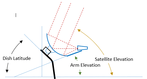

To enable an easier method for experimenting with hitting different satellite orbitals, the offset dish mounting pole can be installed at the angle that corresponds to the latitude of the dish installation. Say you are at 50°N, make the pole angle 50°.
It is important to ensure the pole mounting pivot axis (bolt) is aligned with true east-west and is also level. You can measure from symmetric points on the dish reflector or LNB arm to symmetric points on the mast mounting foot to make them equal. When the symmetric measurements are equal, rotate the foot to get the southernmost satellite in focus. Lock the foot down.
After the mast pivot point is aligned east-west, rotate the mast on the foot pivot bolt until the angle of the mast is equal to the latitude. Now, aim the dish using the LNB arm angle that was determined to hit the southernmost satellite. If you have taken care to be accurate in setting this up, hitting any orbital position is just a matter of rotating the dish on the pole until the satellite comes into view.

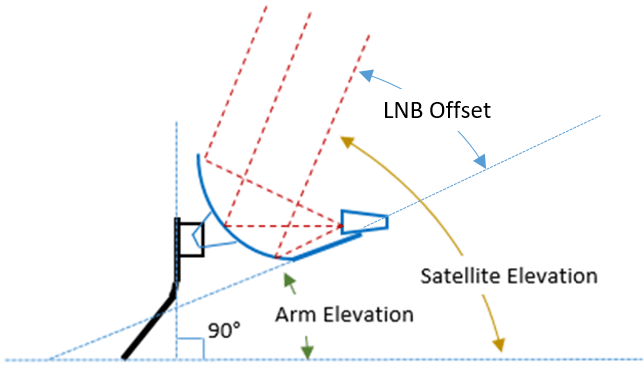

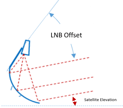

A PM specifically asked about dealing with the angles with an offset LNB.
I'm not sure what the dish offset means in relation to what is being measured. Is it the angle between the LNB eye and the normal projection from the dish center, or is it the angle between the sat signal and the reflection angle to the LNB eye at the dish center? This potentially adds confusion unneccesarily.
My suggestion is to measure your specific dish's LNB arm elevation angle when pointed to the southern most satellite. You will then know two of the three angles and it's simple to calculate the LNB offset angle; LNB Offset = Satellite Elevation - Arm Elevation.
If you have these angles, now it's a simple matter to aim the dish if you are flipping the reflector to put the LNB arm above the dish. The LNB arm elevation angle is now the addition of the satellite elevation and the LNB offset.
Reactions: k.r.

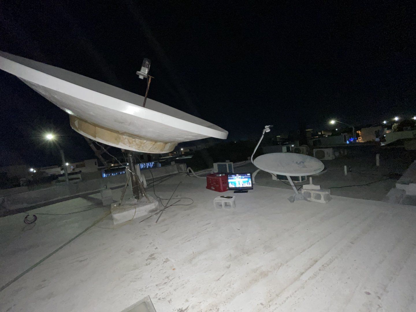

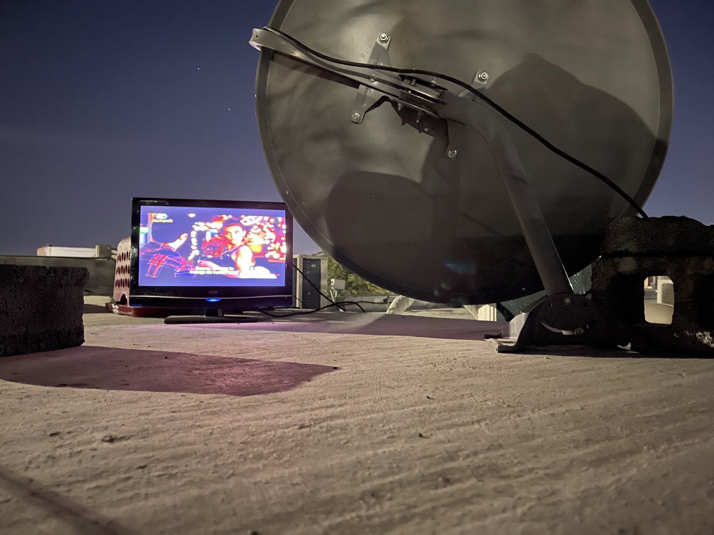

Thanks for your answer, I will test this tomorrow
I tried this yesterday and it worked perfectly . First picture is 30w (9 deg elevation), second pic is 113w
Reactions: k.r. and c-spand
That's great, and I'm glad you found this somewhat useful. Great pics too!
