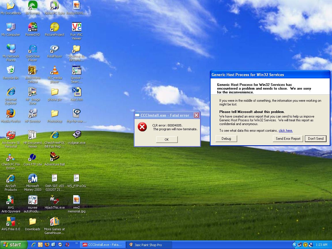

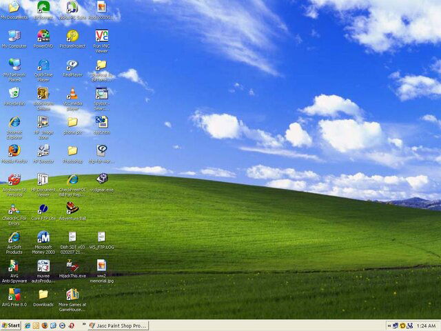

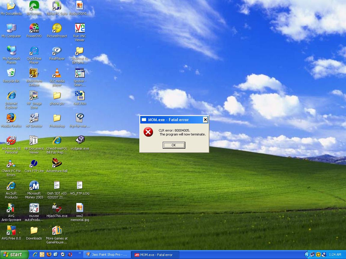

Here are three screen caps.
The first shows the first CCC error and the really nasty error I want to fix.
The second is another failed ATI install error (windows set-up install shield error)
The third shows how the style of the start-bar changed to "classic" all by itself!

The CLR error means your .NET installation is hosed.
Thank you. For the record there were no other aps running during the installation itself. The screen shots are of what is happening now. All the aps in the system tray start up automatically on computer reboot.
