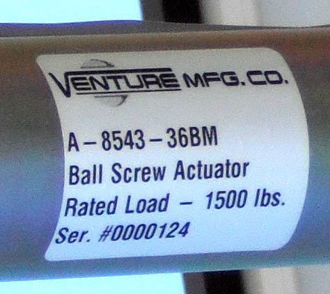

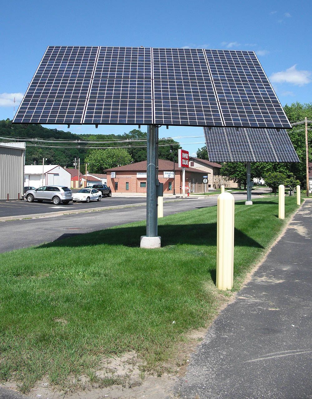

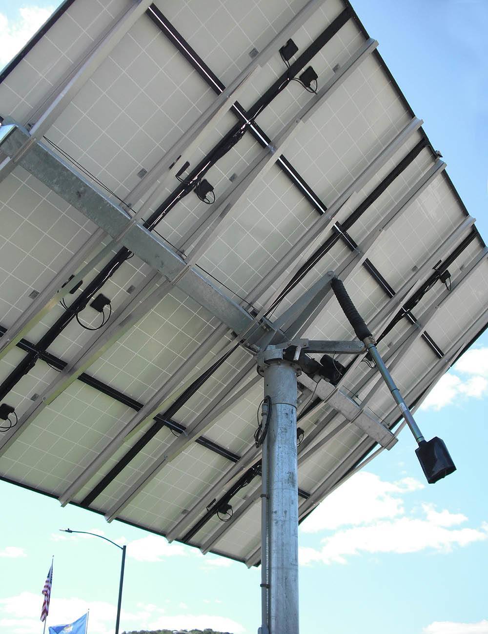

Maybe a bit off topic, but I noticed our city's solar collectors use Venture actuators.
