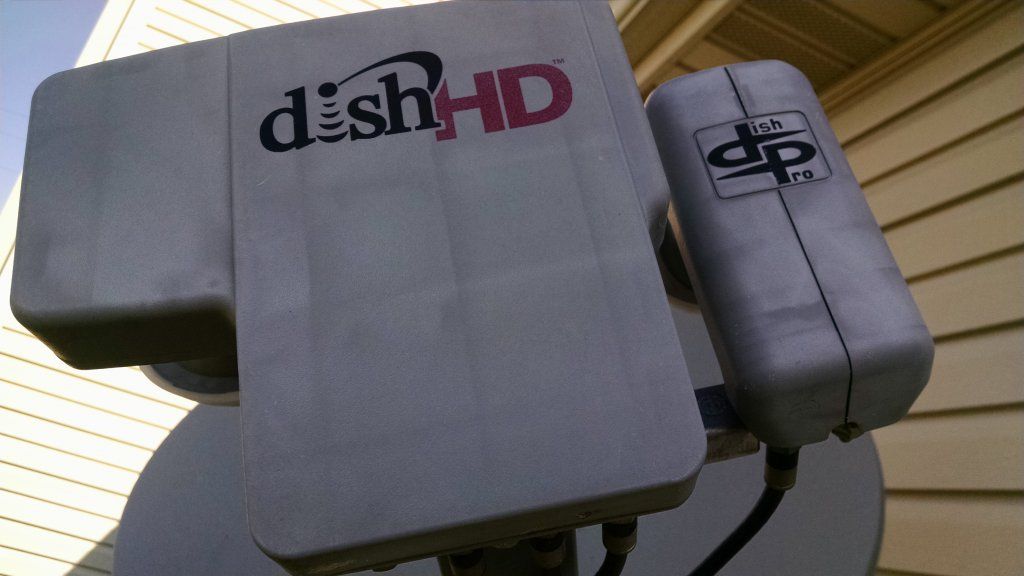

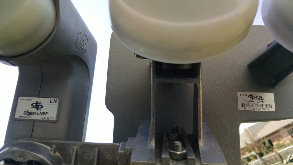

Is that the DISH Pro Plus 1000+ -- the one with the built-in switch?
Here are a couple pics of my Dish 1000+ LNBs. One of the LNBs says DDP and the other one doesn't. There are 4 each coax from LNBs to the DPP44 switch. I pick up 119, 110, 129, & 118.7.
