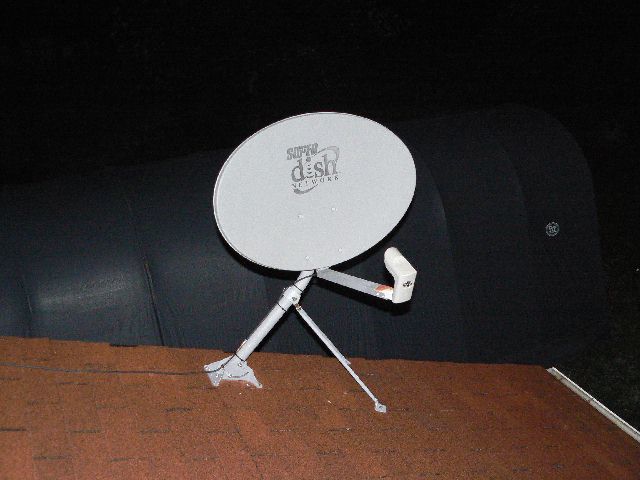

What all do you have in your system? What programming are you getting? I can mod a superdish to aim at just the 129.
If you only have two receivers in your system and don't have international channels, you could use a dish500 for 110&119. Then you could use the superdish for 129. Use a DPP in the Dish500 and send the feed from the 129 into the DPP on the 500 and you are set.
Although it looks a bit funky, as I have to cut in a piece of an old dish300. It really works for the 129.

Superdishs work... a dish is dish. The bigger the better.
