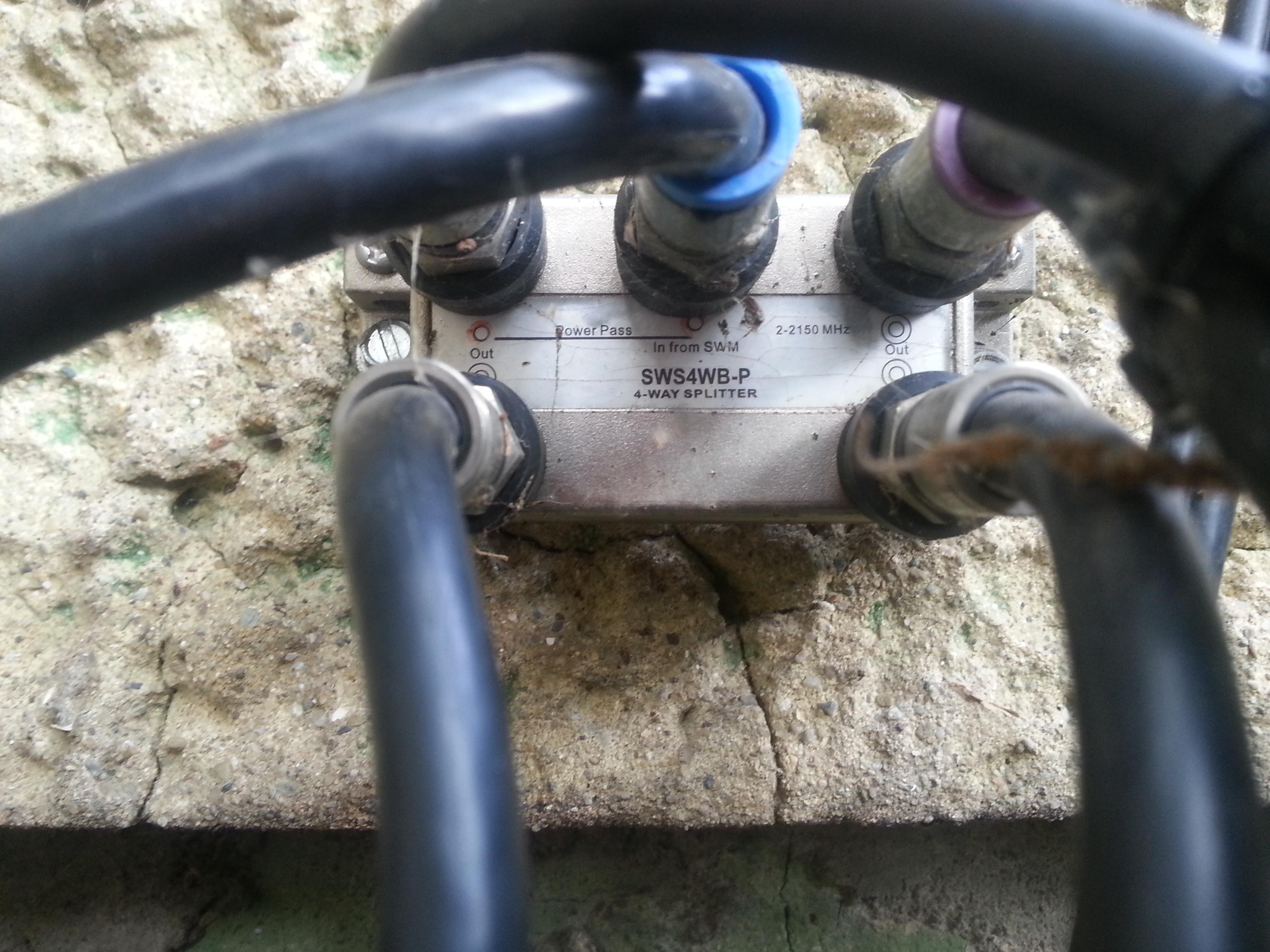

Heres the splitter. The "In From SWM" port is the cord running from the dish. The "Power Pass Out" is running into the basement into the power inserter, then directly out of that into the receiver. The other 3 outputs are currently run to other rooms, but are currently unused due to remodeling.

Aside from the fact that that particular model splitter is older than dirt in the terms of swm technology, everything looks fine, what I suspect you are doing wrong is running the line to the garage into the wrong port of the splitter. You MUST leave the power passing port running to the basement, and into the power inserter and to that receiver alone. It must stay connected as is. You can then use any of the other three to run to the garage. Or swap the splitter to an 8way and keep everything hooked up. Then make sure the receiver is indeed swm compatible. If it is a hd dvr combo, it must be model HR2X. The last number doesnt matter, as long as it starts with a 2. Hook your line up to the sat1 port on the dvr. When you turn on the dvr for the first time, if it was not origionally set up for swm, it must be reconfigured. Let it start up and then when you get to step 2 of 2, its going to freeze at 0%. Hit exit on your remote, then menu. Go to repeat sat setup, and hit dash or the up/down button on the front panel to proceed. The setup should be either 17 (slimline3s) or 18 (slimline5s) and it should autodetect the proper one as well. Hit continue and you should be in busisness.
