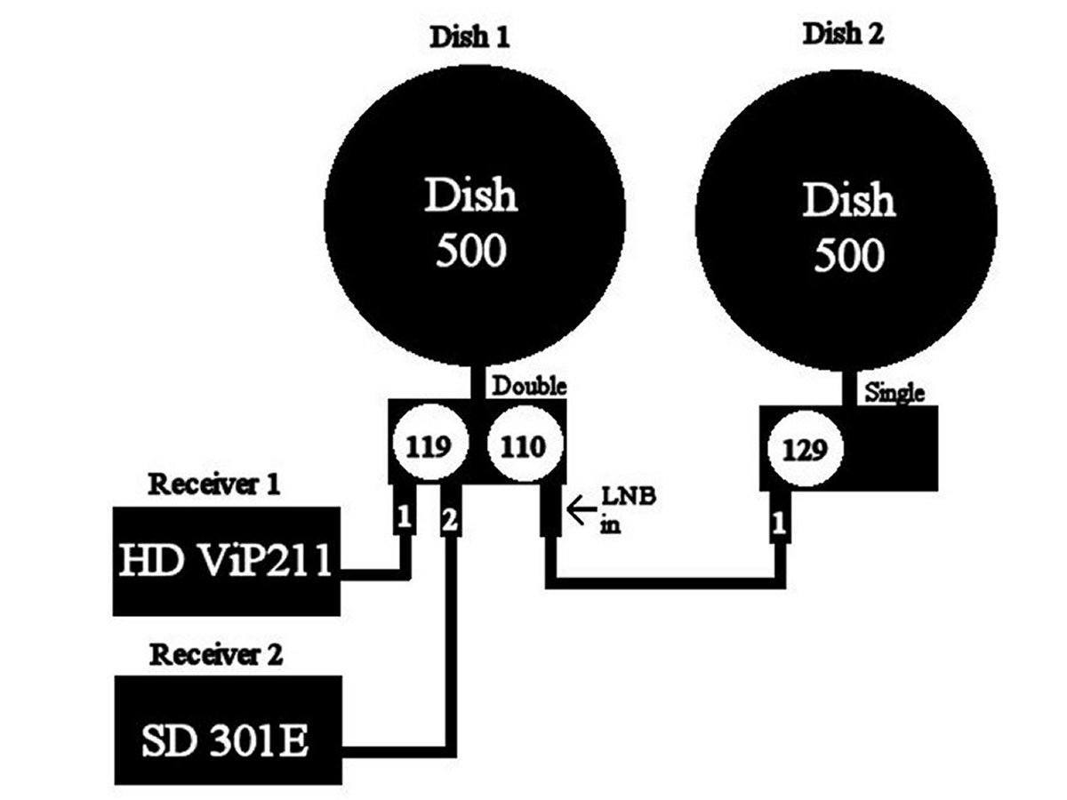

M M.P.DEBO New Member Original poster Feb 26, 2008 3 0 Feb 26, 2008 #1 I want to add a third receiver (HD ViP211) to my system (See schematic) and wanted to know if a DP34 switch will work so I can get the HD signal to both HD receivers with out degrading the HD signal. Attachments 1.jpg 42.4 KB · Views: 231
G garys SatelliteGuys Master Sep 29, 2005 7,621 37 Greentown, Pennsylvania, United States Feb 26, 2008 #2 Yes, that will work, you will have to have 129 input into port 3 on the dp34 switch.
