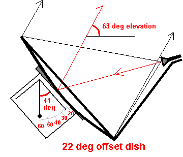

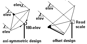

Offset dish "seem" to be pointing much lower than they actually are, usually by around 22º
