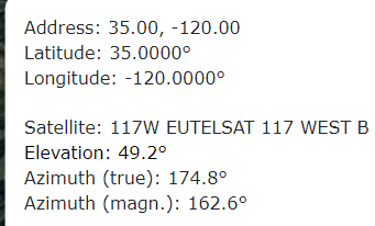

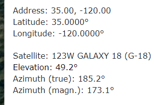

I also got a motor. How do I find out what the center sat is at lat 35, long 120?
From dishpointer.com, either 123W or 117W each have reliable full-time linear transponders.
