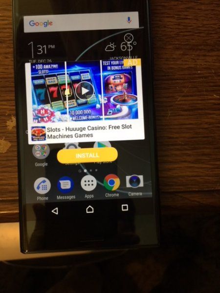

OK I give up! This is the worst part about owning an Android phone. How do I stop these?
I've been following the suggestions on YT videos and they got rid of some popups but I still have them on the Home screen everytime I turn the phone on.
Why doesn't anyone complain about this? Am I doing something wrong that I get these ads?
I already went to Google settings in the Ads and tried the toggle off and on and all that seems to do is match the ads to who they think I am or just random ads for anyone. They do not get shut off.
HELP!

Well I discovered 99% of the ad popups are gone. I eliminated all non OS aps except for You Tube which I need, and the remaining I set to Block notifications in the settings. However, while I no longer get the popup ads while using the phone, they still popup when I plug in the charger. It is accompanied by a "swipe>> to dismiss" which I do and then gone until I plug in the charger again. This is before I enter the security code or my finger print to unlock.
If the News app you deleted fixed it sounds like you found it. As a general rule First guess based on when it appears (before unlocking) it is from an anti virus app. Avast is known to do that.
Second guess any app in the GO App family. Third guess ES File Explorer. It is often a feature that can be turned off inside the offending app. For ES File Explorer it's the Battery Boost feature. For Go Z Launch it's also a speed booster/battery option.
Thanks, I'll look into your suggestions. For now the ads only pop up when I plug in the charger. Otherwise all are gone.
