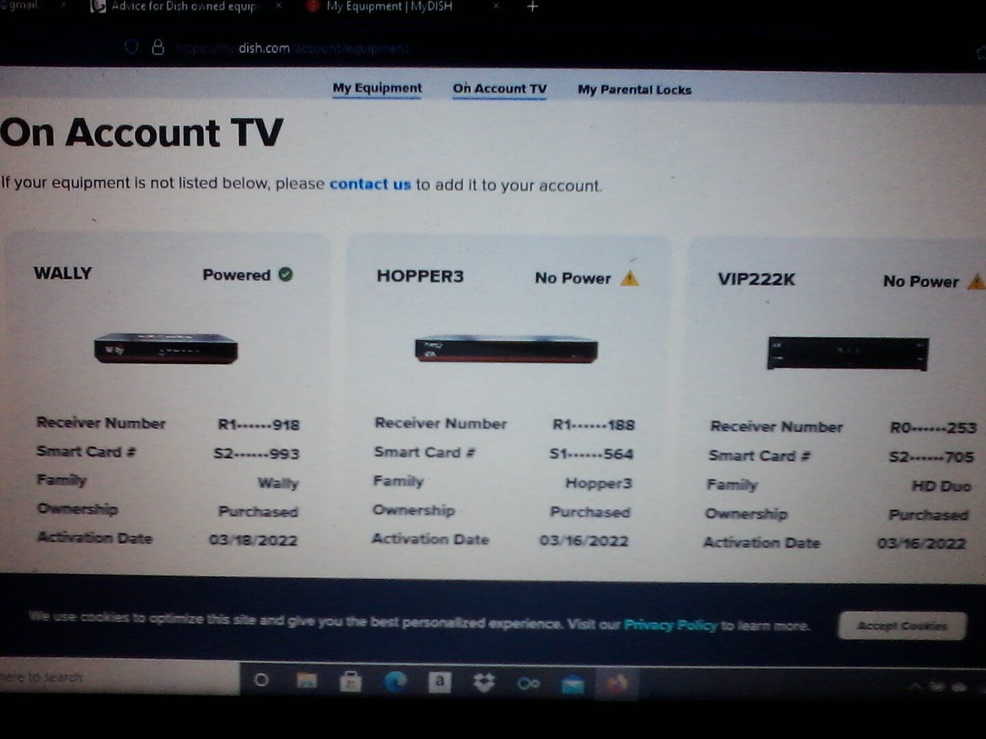

For starters, I can tell you that you may need to deactivate your Hopper 3, at least temporarily, in order to get Dish to activate the ViP222k on your account. After you get your ViP receivers added to the account, you can log into your mydish account at any time to activate and deactivate any combination of these receivers you want, as long as your account is set up as a Dish Outdoor account.

The reason why I did it before was that I ran into a glitch that comes with having a ViP222k active as the main receiver and also having Hopper or Wally equipment active at the same time. This combination of equipment can automatically deactivate DVR functionality on any active Hoppers (regardless of which model) or Wally receivers. (Deactivated Hoppers and Wally still work for playing existing recordings, though.) There is a work-around for this (calling a special Dish support phone number to get Hopper DVR functionality re-enabled) but I found that to be too much of a hassle, considering how often I was switching out which receiver I was using at that time. However, with a ViP211k, DVR functionality remained enabled, even with the ViP222k active, and with Hopper/Wally DVR functions disabled.

Here, this shows the last time I had both my ViP222k and Hopper 3 active at the same time, 3/16/2022:
