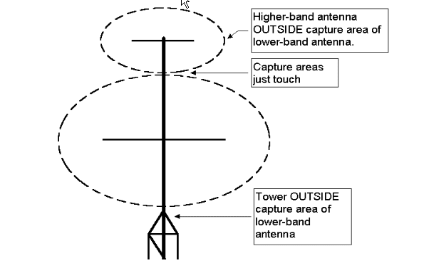

I remember reading something about stacking the antennas and interference issue but right now I can't find the article that I read. To be honest I'm not sure without finding the article if that would make a different. If you've got a truck with a boom then to me it would be easier to just install a new VHF antenna, mast, rotor and DB8, put everything that you can together on the ground and have him lift it up.
I found another article which highlights the issue with stacking, it's just been a long day.
  • The capture area of the lower-band antenna is physically much larger than the capture area of the higher-band antenna.
  • To avoid any interaction between antennas, the capture areas should not overlap.
  • To avoid interaction with the tower, the top of the tower should be outside the capture area of the lower-band antenna.
  • It puts large wind-loads on the mast, which may bend or break where it enters the tower, should have a good mast, not a cheap one.
Antennas tend to rebroadcast the signal from their elements. The distance from the antenna of the effected area is dependent on the wavelengths involved. The UHF (DB8) involves short wavelengths while the VHF antenna will involve much longer wavelengths. The rule of thumb is to put two IDENTICAL antennas no closer than about 1/2 wavelength of the lowest frequency that the antennas are going to receive. Using that rule of thumb and channel 7's wavelength you wouldn't want them closer that about 2.6 ft. apart.
However, since you are dealing with a completely different TV frequency range from the antennas you might get by with putting them even closer if you need to.
