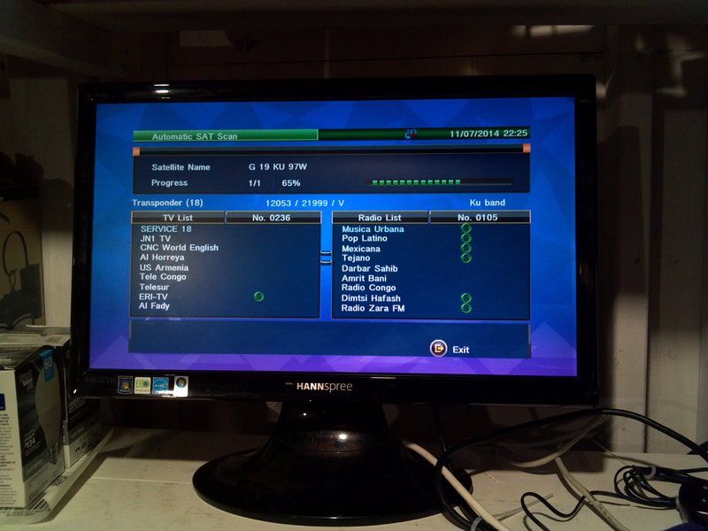

It took a few to finally lock it down. Each time I'd tighten something it seemed like something else would get a bit off and I'd pick up some of galaxy 19 and some of either the pentagon channel or the cctv. I thought it was cool that I could hit a little bit of two birds at once. Even though the quality is less than stellar. But Hey I only have a winegard ds2076 30 inch dish! Makes me consider more about putting another lnb on there and getting another bird...

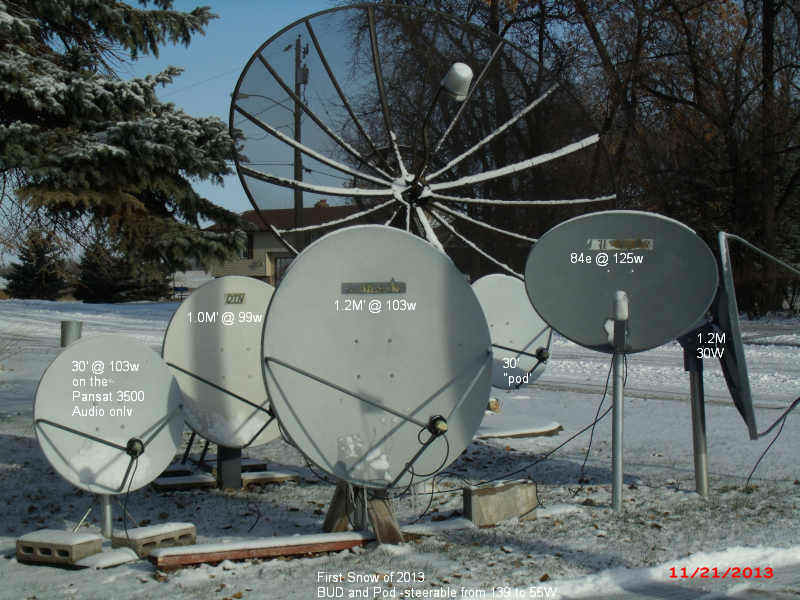

30 inch* dish is a bit small for more than one LNBF. 1 meter or greater is a lot better. Motorizing the 30 inch is a better choice.
*I have 2 30 inch 'commercial' dishes and 2nd LNBF performance isn't that great. And the minimum 'spread' was like 8 or 10 degrees. 91 and 101, 97 and 107 etc with the dish aimed half way between. (Both LNBF's offset from the focal point to 'equalize' losses) I went with a combo of fixed and one motorized. Farm-fall-13.jpg

Well I finally put on my multi lnb bracket and played around until I hit 103w...Thinking I would get the NBC stuff... Well I got it. I think... I have
amc-1/19a embedded
nbc sd dvb-s
amc1/19c embedded
nbc sd dvb-s
ms4 ms 10 ms20 mstanley sd
microhd----this is a channel with the beach pier thingy
20
50
100
10
30
40
Says I get 15 channels in all!
Most show scrambled and the NBC ones are always color bars and test tone that I can see...Realized now that the NBC stuffs I wanted are on 72...my multilnb bracket isn't that big ha! Here though I cannot get the cozi tv...I had to skewe the opposite way that dishpointer.com is to get the NBC stuff...
Oh I do get some channel that has some sports on it...May be it was a waste of time to aim at this bird now unless something pops on on those NBC ones...
I was hoping that I would get enough overlap to pick up the pentagon channel on 101w but no joy there!
