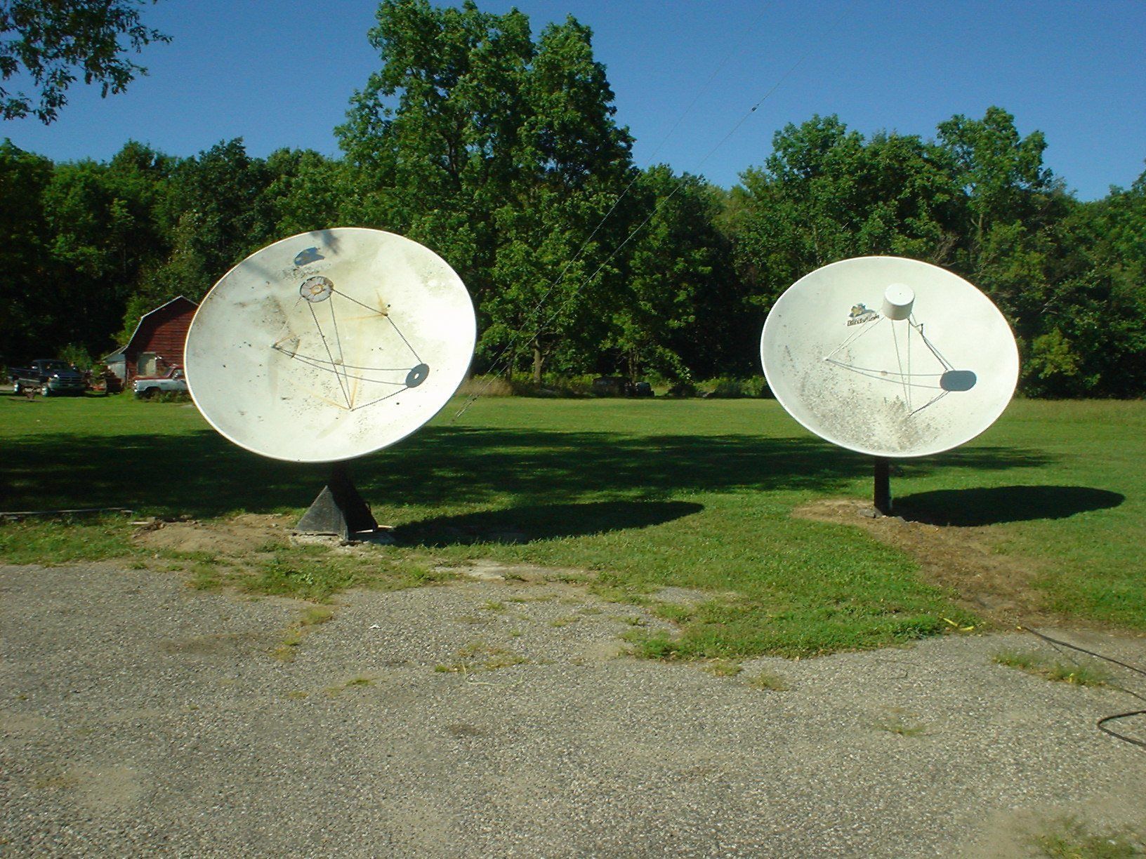

I'm fortunate to have sold BV many years ago, they're the BEST...and I'm VERY fortunate to now have two installed, one stationary on the left (but soon to be motor-running) and one motorized, (on the right) feeding a 4DTV for the past year or so with an original LNB from Birdview.
The stationary (left) one is aimed at W-5 and checked for signal by using the 4D, currently using an original "hi-block" Birdview LNB. (just aligned yesterday for SRL satellite feeds, and a possible conversion to using the DSR-410 for simplicity.)
The other (right) one will be driven by a g-box when the 4D is moved to the w-5 only dish, then the the motorized (right) one will be used used for FTA feeds since the arc is already perfected.
