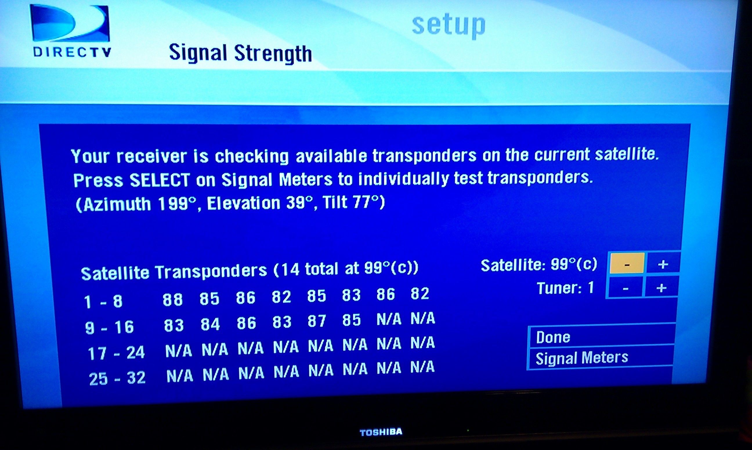

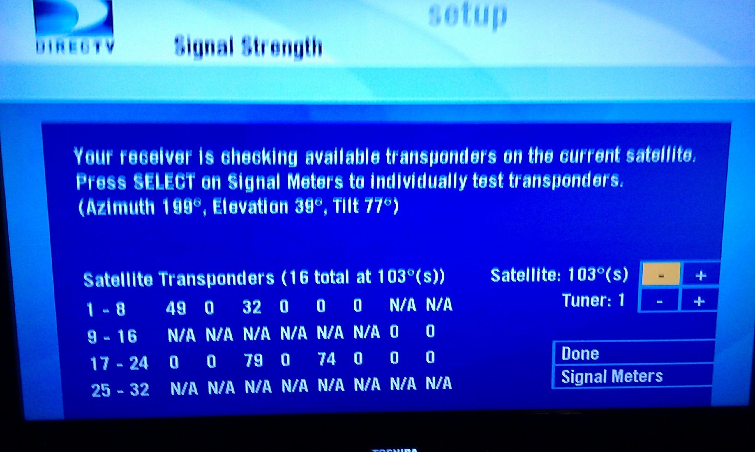

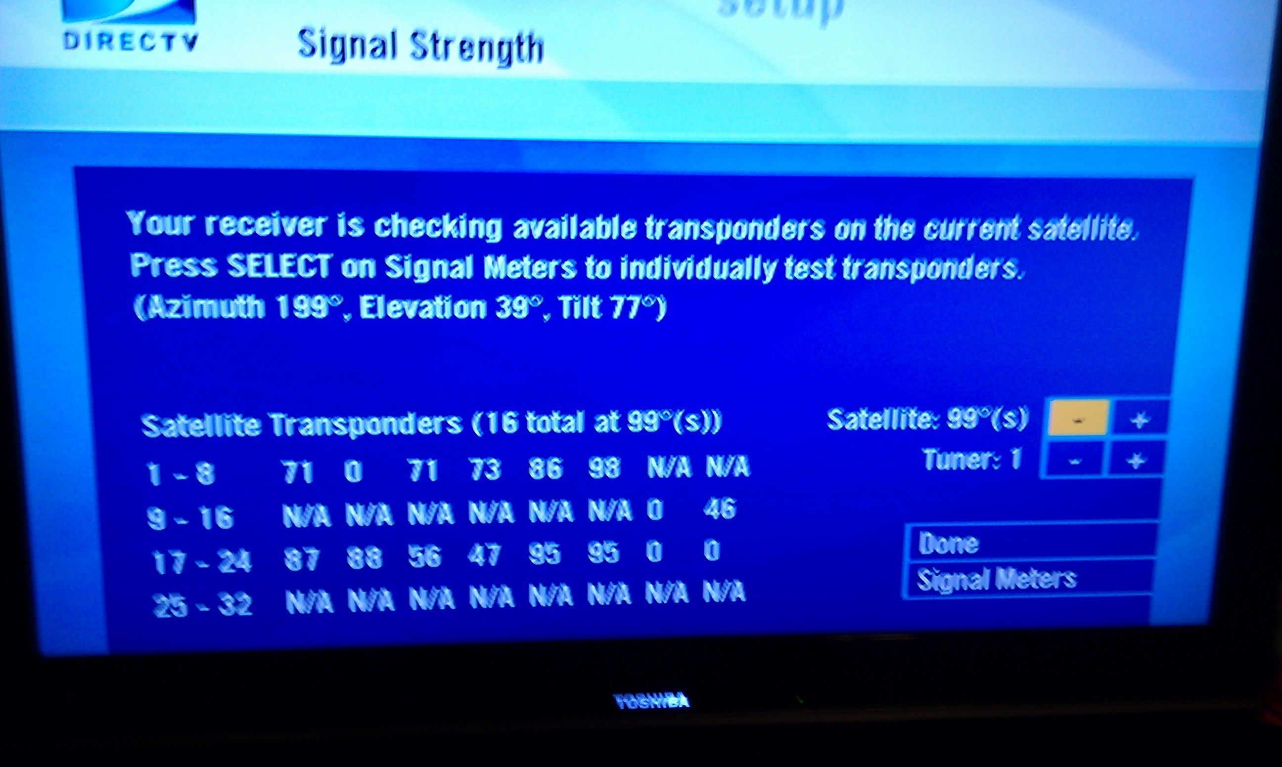

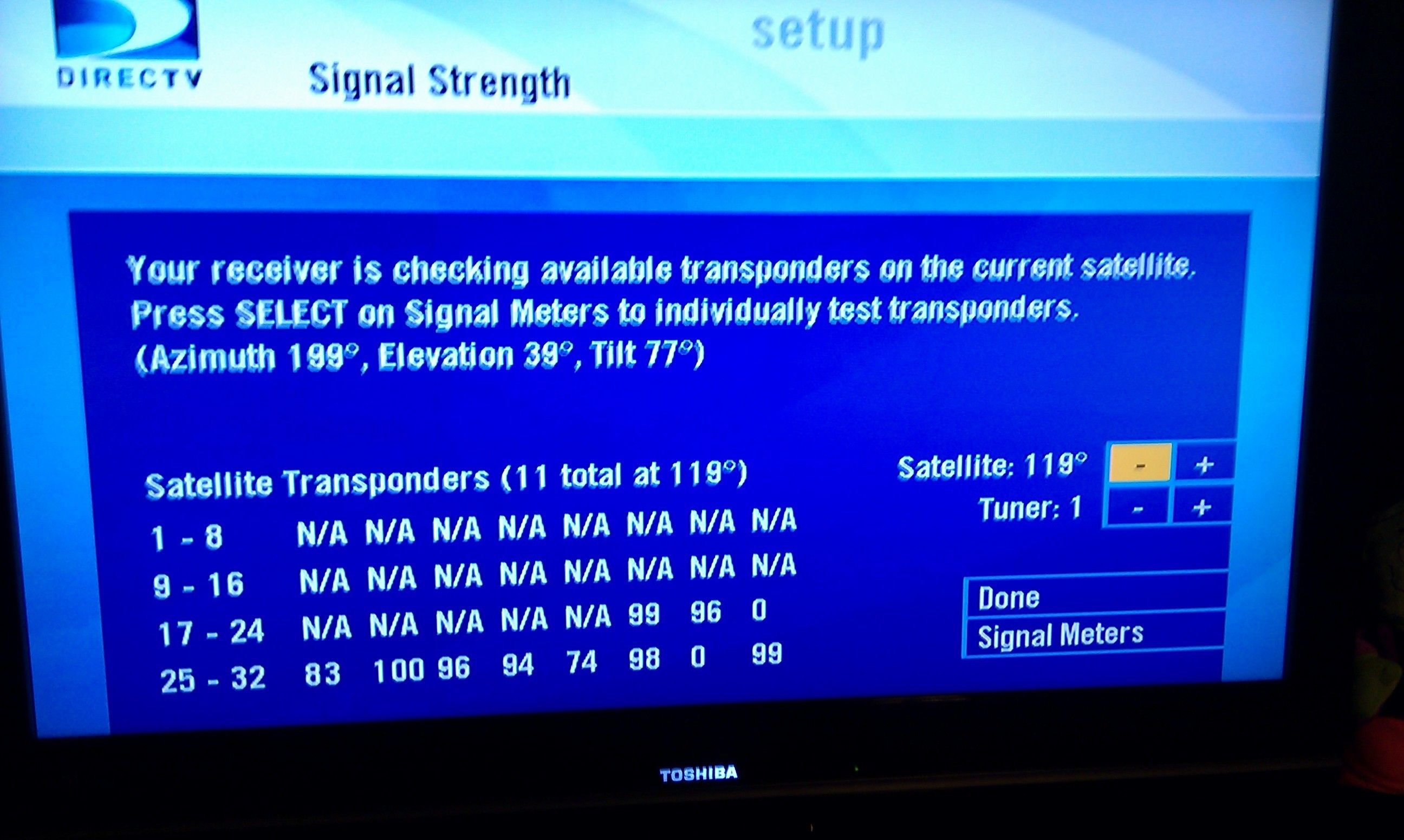

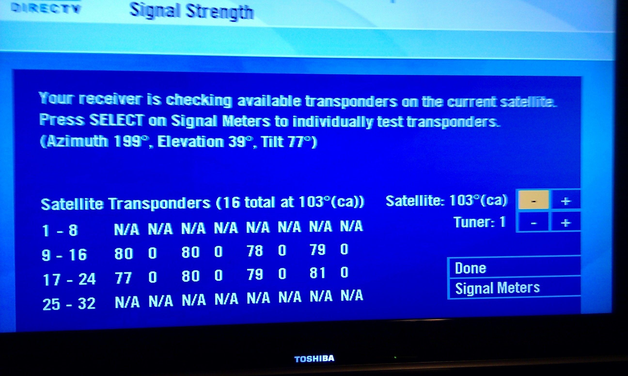

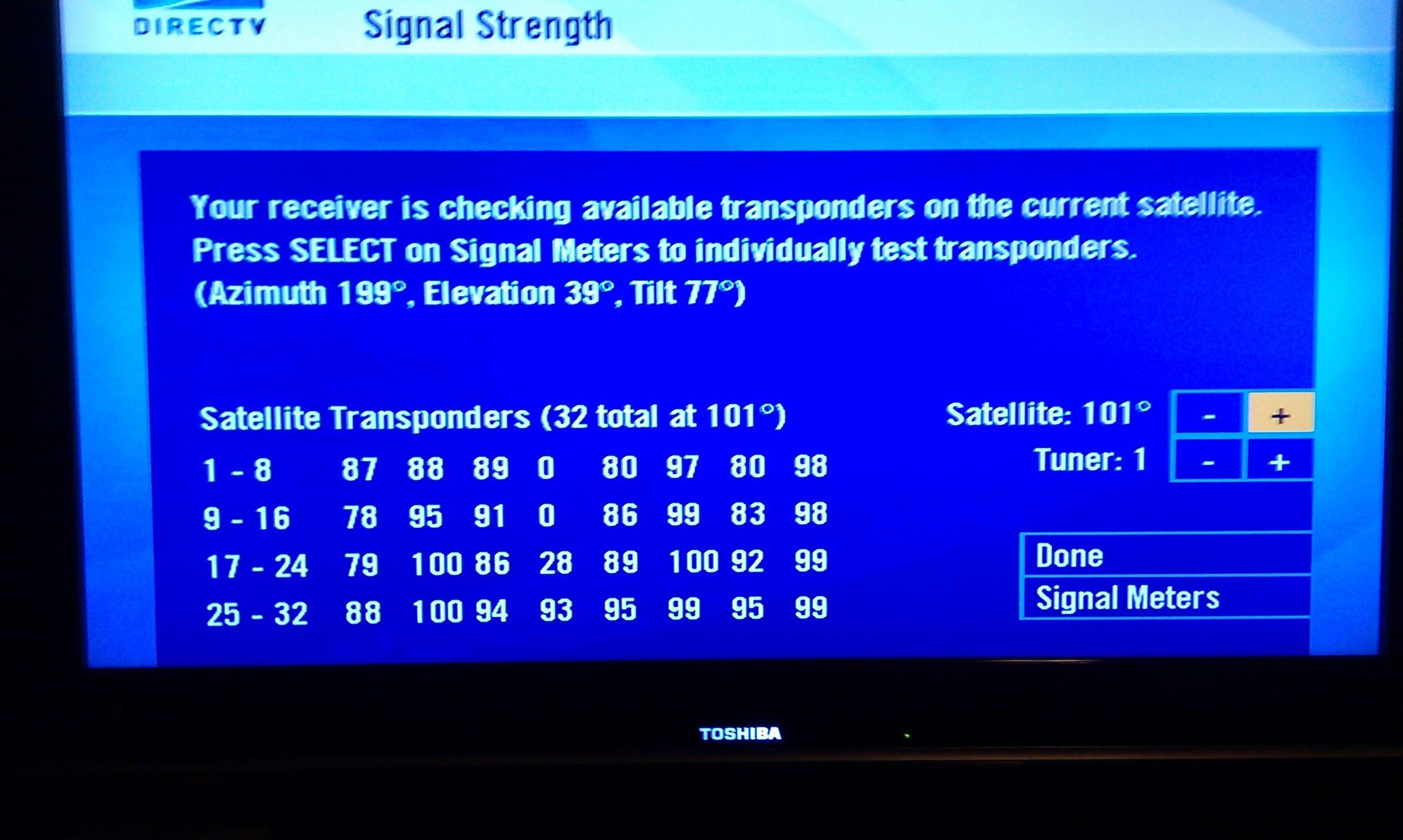

Here they are
From what I can tell, they all could come up some.
You have enough to have TV of course, but they could be in the 90's as the avg.
When I am close, like you are, I will occasionally, have someone watch the meter and apply slight pressure on the 4 sides of the reflector and see what happens to the signal, you should see it improve in one direction over the other. (make sure your settings are tightened before doing this)

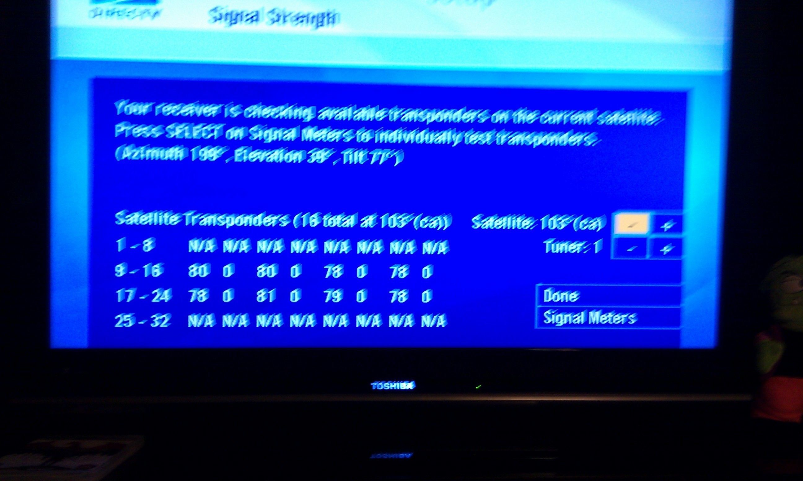

Tried a new LMB, tried to reauthorize same channels saying 771 on tuner 2 although tuner 2 is fine signal/numbers wise. Replacing the LMB increased signal strength by 15% across the board.

Yep, replaced it and my signals increased quite a bit but the same channels are 771. I'm thinking maybe receiver or switch now?
Switch was bad... wierd that only some channels would not work.
