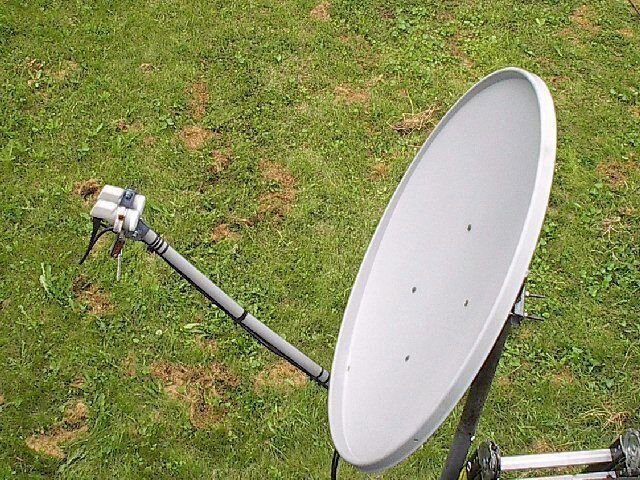

If you want to get fancy, you could setup a 30" dish to get 97W and 101W with 2 LNBs.
Something like this :D 84cm at 97 & 101.
