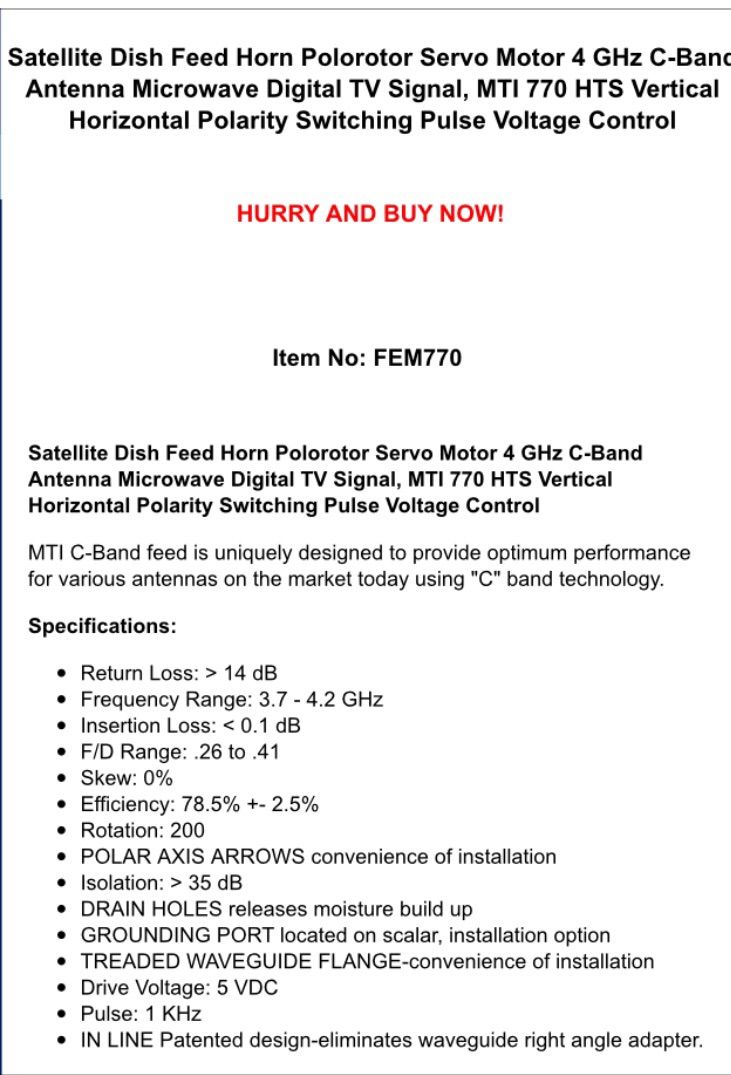

Titanium, is this like what you're talking about, would this work?
That one is designed for C-Band only.
Reactions: KE4EST
I agree, I was just posting that for reference, I didn't see the price at the bottom until prime said something.
