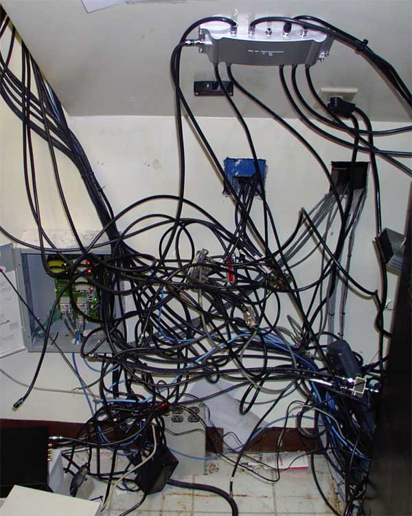

As to that last pic with all the wires...all I can say is, that person apparently has an IQ of at least a thousand if all that is connected correctly. It's beyond amazing that he could even keep track of what connects to what in that rat's nest.
Reactions: KE4EST
When in the H E double hockey sticks did you get behind my entertainment center??
No, whoops, there's the skeleton (of a service tech) tangled up in mine. (I was lucky enough to escape)
Hey, But it works! (It used to be [almost] that bad) I got more horror stories but are 'commercial' in nature.

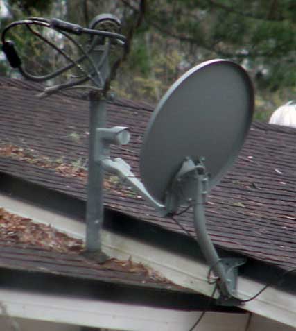

I like the pizza dish up the pole. (not really)

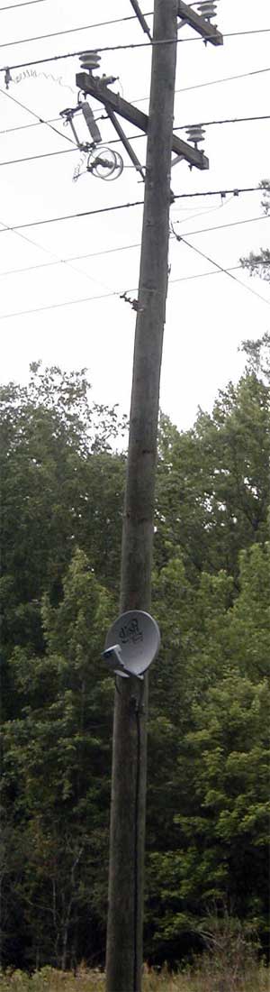

I was sent on a service call once and the pizza dish was 35 ft up on a 45' tower. One of those angle iron things. Tapers in size every 10 ft or so. You get the picture.
I said "nope, sorry" They asked "why". They ended up taking it down ( that's a story in itself*) and I installed it correctly. ON AN EXTERIOR WALL!
*two brave souls. One riding in the bucket, holding an extension ladder, while the other tried not to kill him, while lifting it to max height.
Thinking about it, they had practiced this before (you couldn't tell) putting the dish there in the first place.
