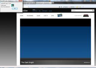

Well I got 10 seconds of one of my recordings streaming earlier but can't replicate it. One thing I have noticed though is that when I sign into dishonline in IE I occasionally get a popup for ULead MP3 Codec with an OK button on it. If I don't click on OK, the window for the player goes blue with a black letterbox (as though I'm starting up a DVD) then freezes until I press OK, at which point I get 'Authorizing' then 'Connecting' before the usual error message.
