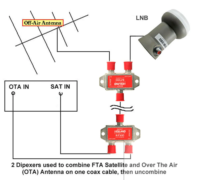

Satellite splitters should NEVER be used for antennas.
Satellite splitters are very well built, but they are really terrible for antenna use. They're designed to pass information between the outputs and that means a lot of interference can creep in. If the satellite splitters have a pink or green label, if they say Holland or DIRECTV, Echostar or DISH, you will want to replace them.
This splitter will work really well for antenna use. It's economical, well-built, and will pass power between all ports. As Tyler points out, that's important. But in a pinch, even the cheapest splitter you'll find at the dollar store will be ten times better than what you get from a satellite splitter.
