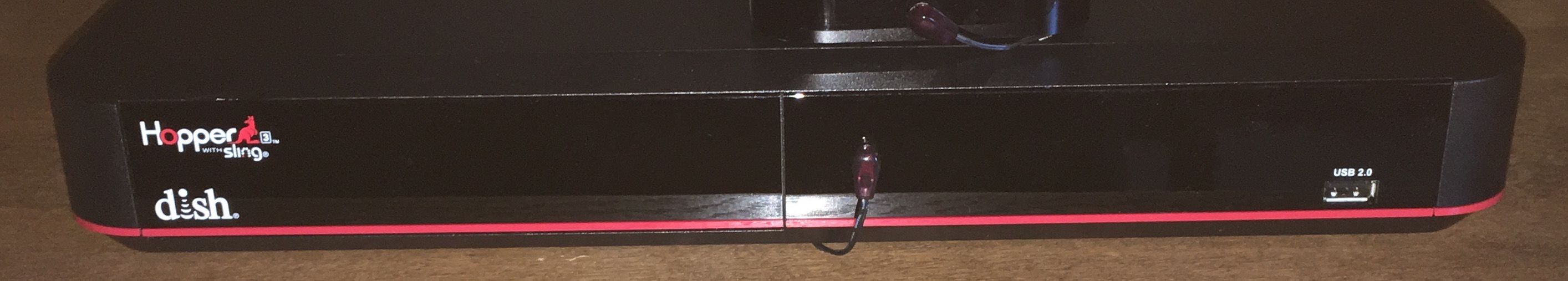

Has anyone else tried an IR extender with the Hopper 3? Anything work? Does anyone know exactly where the IR port is on the Hopper 3?

I found the most sensitive location to be just to the right of the center line.
About here:
