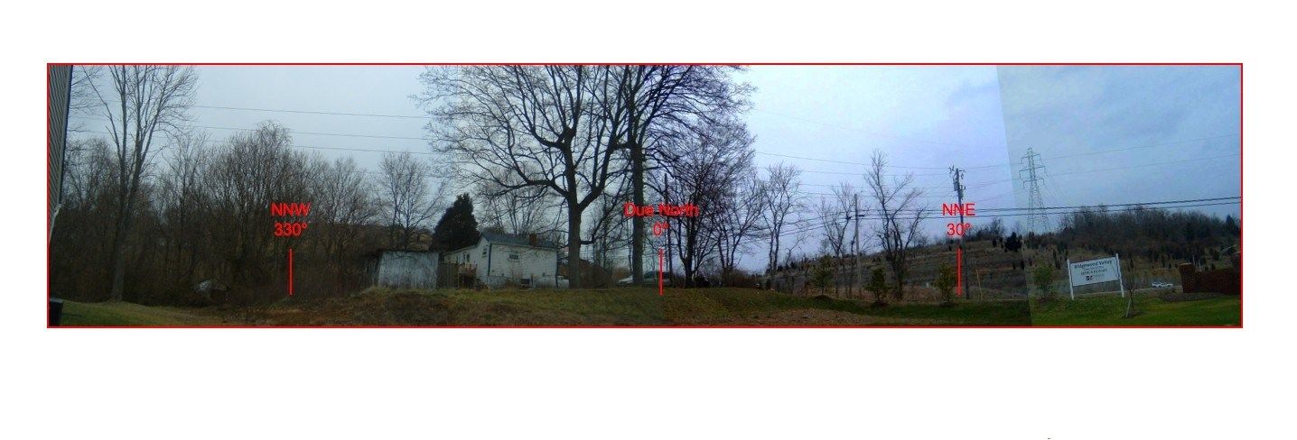

I managed to take some shots northward of my house and make a panoramic picture. Since I do not know exactly where the towers are, I decided to do a 60 degree "sweep" northward. As you can see a few degrees can make a difference. I had to connect a bunch of pics together to get the whole 60 degree sweep. So you will have to excuse the obvious artifacts of a collage. I do not have fancy photo editing software, just the generic stuff. Of course I was on terra firma taking the shots, so imagine a perspective of 15 feet or so higher.

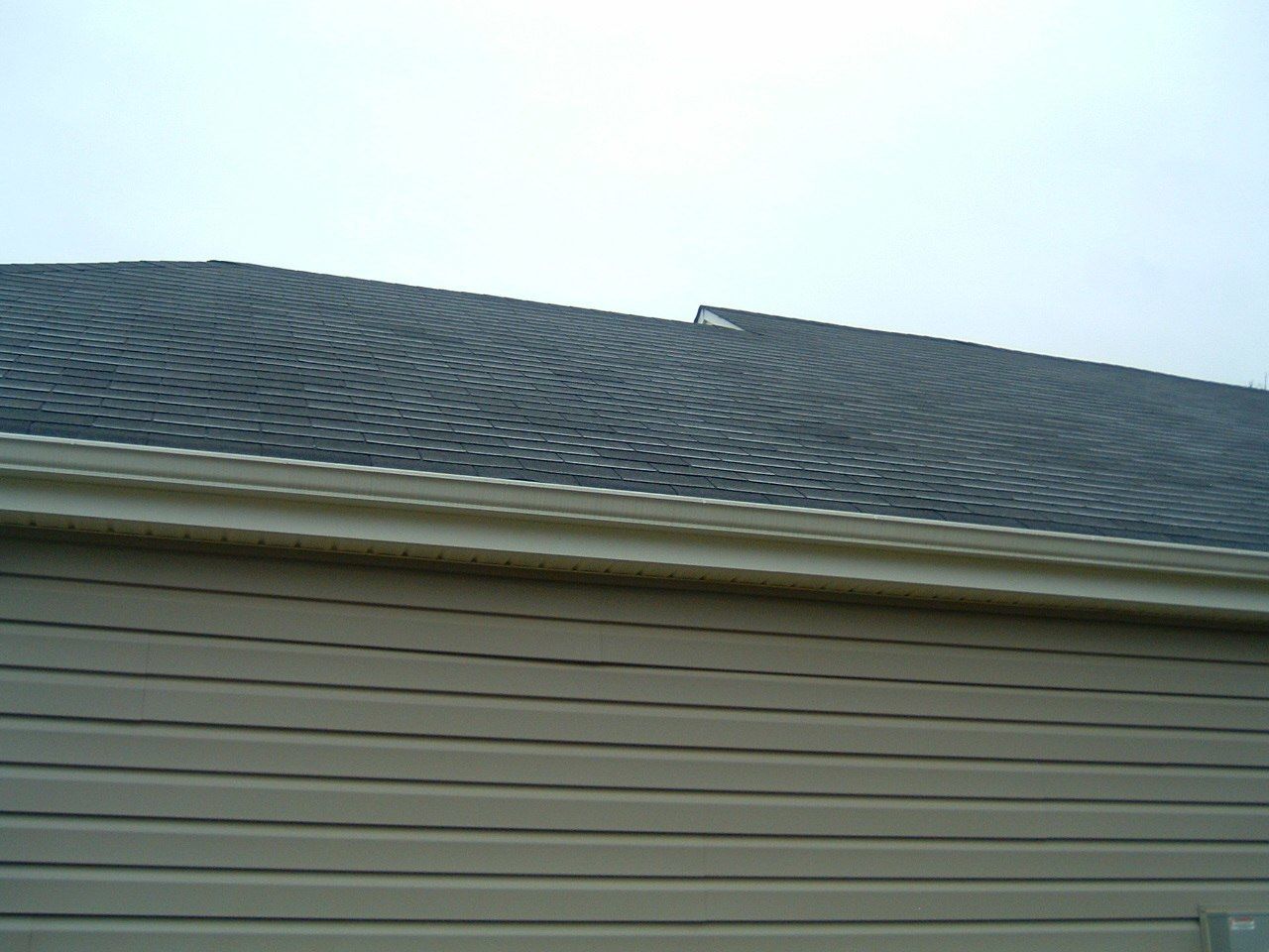

It turns out the signal would be going through my roof, rather than vinyl siding. Just regular asphalt shingles. I decided to take a shot of the roof where the antenna would be hiding under.
You will also have to excuse the dumpy house in the pic (neighbor). We are on the edge of a brand new development. So as the city slowly invades the older countryside, our type of eclectic mixture of neighbors are inevitable.
Hopefully you can get a better feel of what my conditions are like. Also, how much would foliage affect the signal this summer? Hope you all like the panoramic. I know I spent way too much effort on it compared to what some of you whizbangs out there could do.
Also, how will the high power lines affect things, if at all?

Well, it's hard to tell but I have an idea that you can get a decent signal though your antenna will probably be pointing right at your neighbor's house. :) If the 0 degrees north you show is true north anyway.
