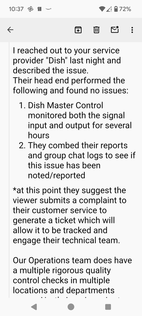

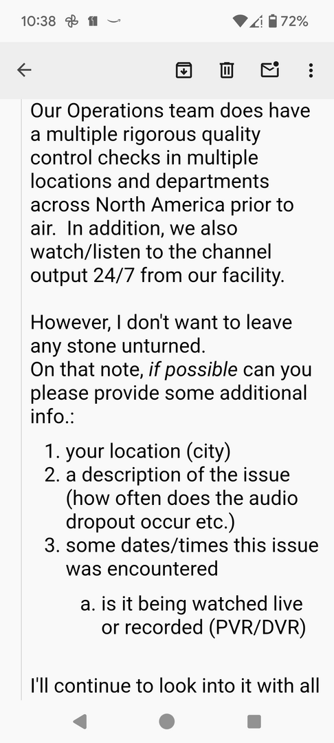

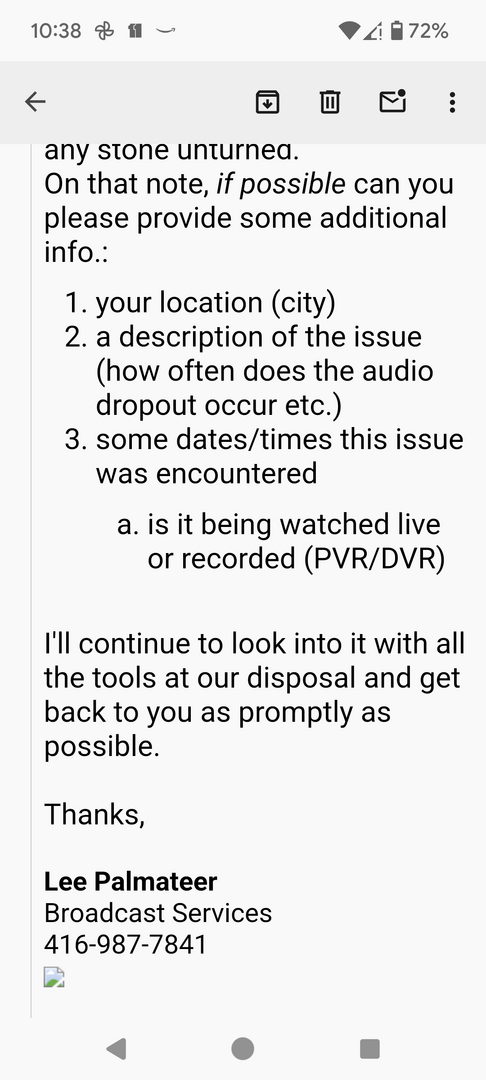

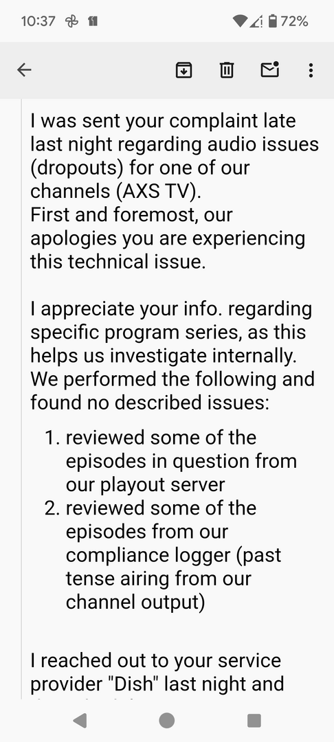

I finally received an email from AXS TV this morning, I emailed them a second time last night.
Just got off the phone with Dish and a ticket has been opened with engineering. Should be working on the audio issue and have it fixed today. We shall see.
I was told to call back tomorrow if it still happening.
