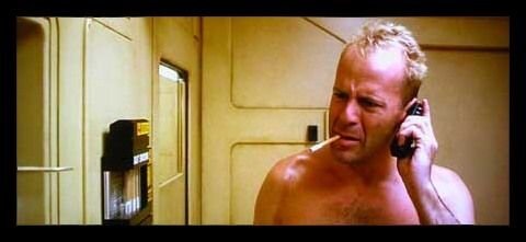

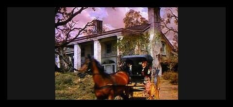

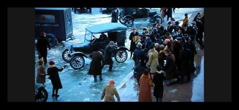

This is what you should be seeing:
2.35 on a 2.35:1 screen
16:9 on a 2.35:1 screen
4:3 on a 2.35:1 screen

If your pictures look like the images I posted it is correct. 16:9 will not fill the screen, period.
