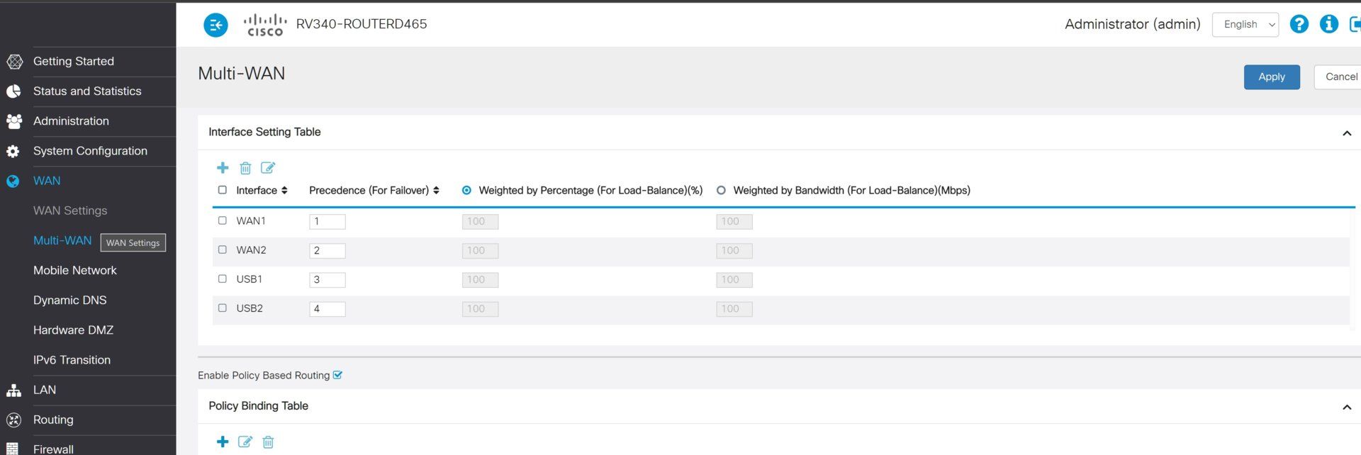

What do you want to know?
I'm using a Cisco RV340 router, which can be configured for either failover or load balancing, with Spectrum as my primary ISP and HughesNet as secondary ISP. The router also have two USB ports that can be used for cellular modems, so you can failover or load balance up to four connections. I have it configured for failover, since who would want to load balance with satellite connection. In the GUI it is very easy to configure the multi WAN capabilities.
Well, you told me pretty much what I wanted to know: that it is easy to setup and works well.
