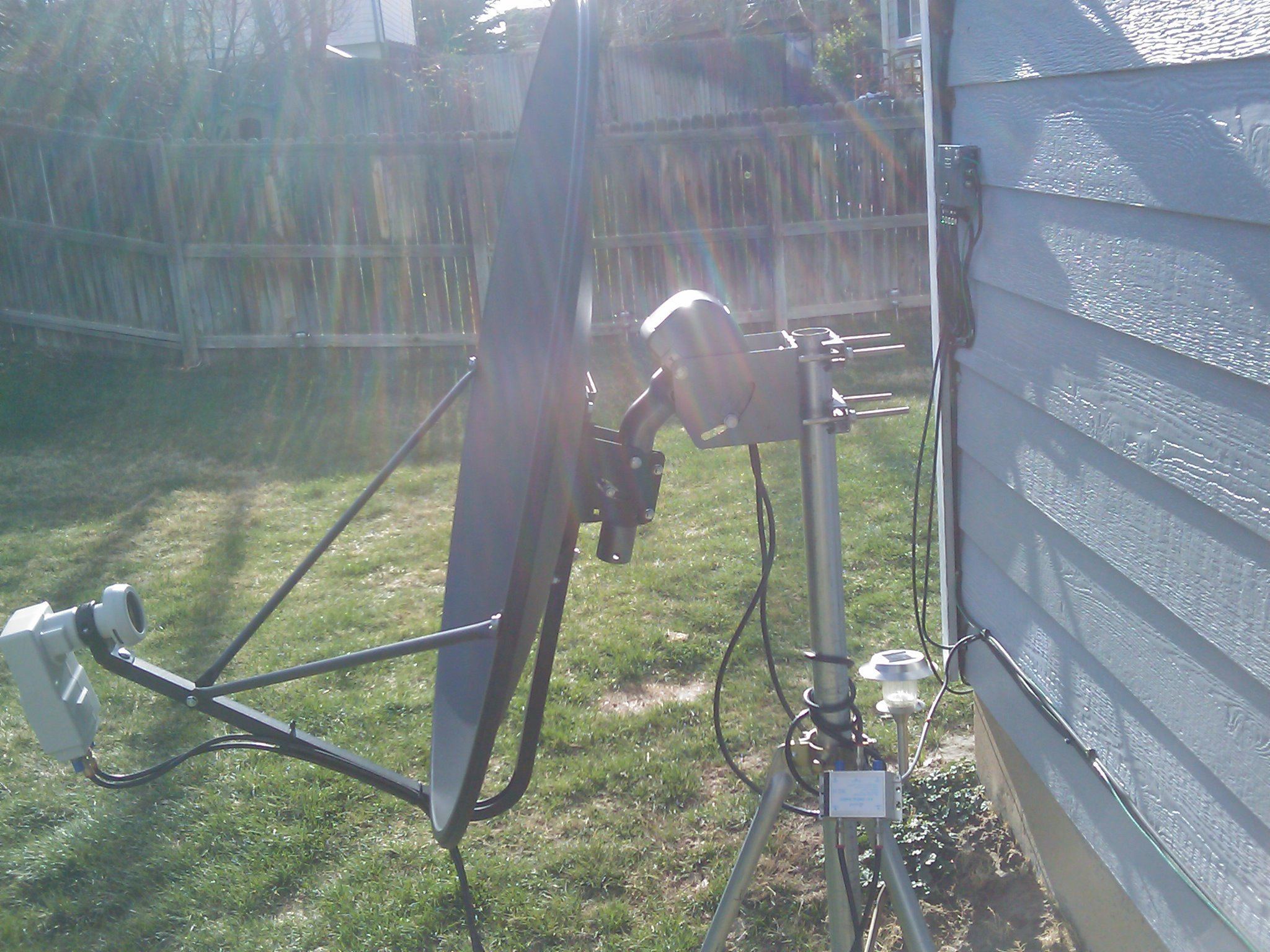

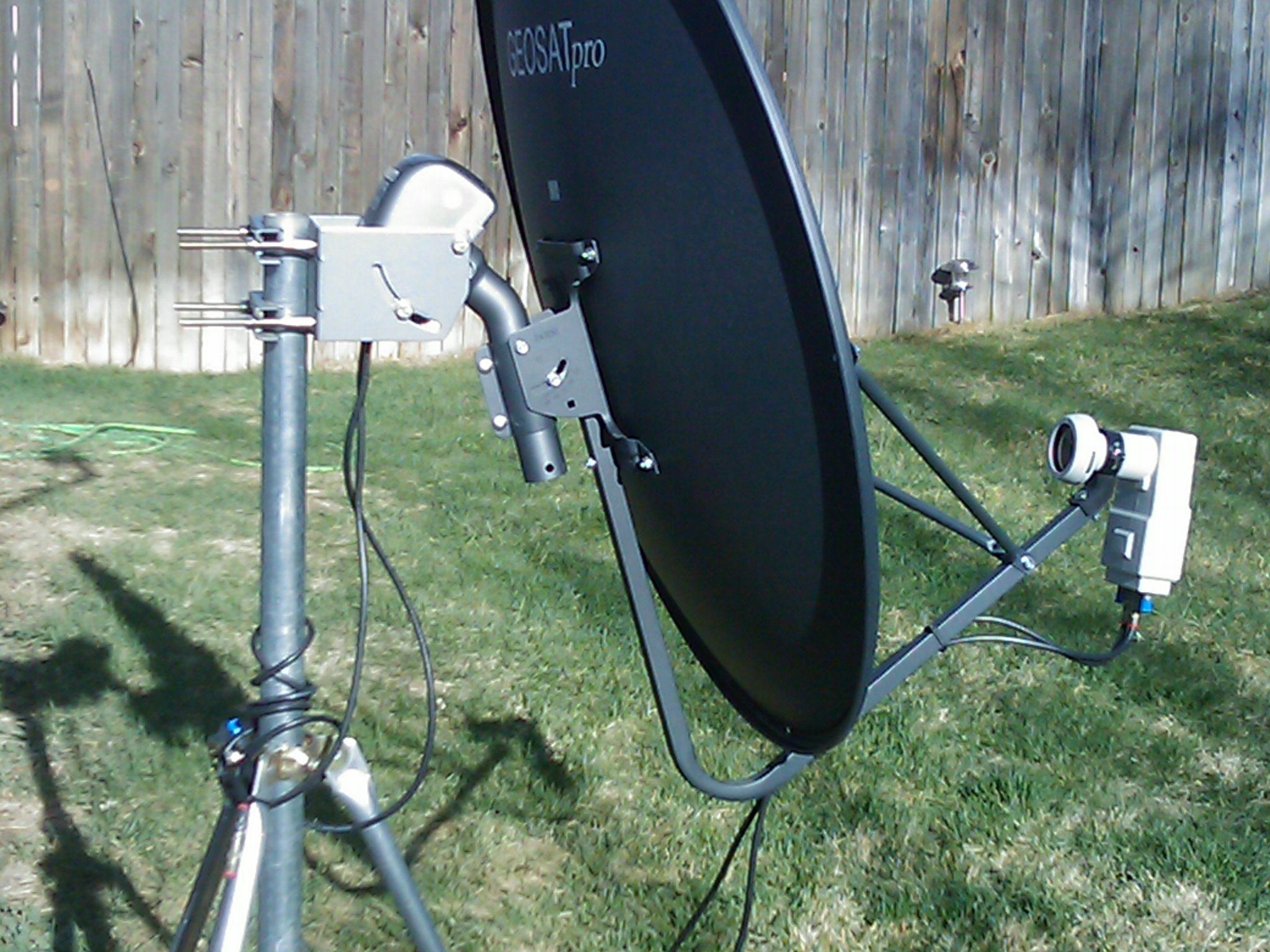

Has Anyone Motorized the Geosat Pro 90cm dish? I hadn't planned to but when considering adding a cranked arm to achieve an elevation less than 10 degrees for the poor man's H-H mount I realized the elevation bracket pivot bolt blocks the top of the bracket. If I try to use a cranked arm from the bottom the polar axis would get in the way of the dish.
I have mine mounted on a DG380 motor. Just make sure to get a 42mm tube. Most have the proper holes in it for the bolt in the mount to go through. Pics below that I just shot with my phone.
Many, many thanks for the great pics!
