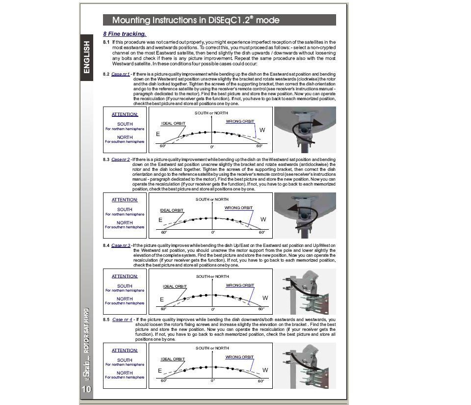

Hi all!
I just put a new motor on my 1.2 and am off the arc by just a bit. Some where I saw drawings that told you what way you needed to adjust to correct. I think it was here but for the life of me can't find it.
Any idea where to look?
Thanks
heres one should be about the same for most all motors
