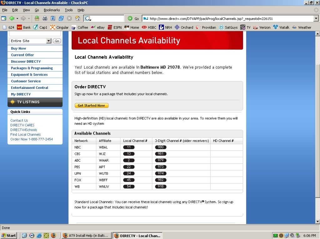

Well, sorry to say this, but according to the DirecTV website: 21078 does NOT get MPEG4 HD locals via satellite. Did you verify this via the locals tool? This makes it hard to be sure IF your are really supposed to get them, even thought you are more than likely in the spot beam. I shoe 21078 as Havre De Grace, MD *See attached.

charper1 - I did not use the online tool, but I did call DirecTV directly before ordering the upgraded dish. At the time, I was not even aware that I would need an upgraded dish to receive local HD content. They then routed me to installation services and setup my original appointment with MASTech.
You definitely NEED to call DirecTV back. You need to get you call escalated past regular CSR and their supervisor; maybe even a direct call to customer retention (someone will post the #) and explain your situation. Be sure to mention what you were sold/told versus what the online zip code tool shows and how the can rectify ASAP.
If you ARE supposed to be receiving the HD locals via sat, then get the call directed to tech help. Look at your DirecTV online account and see if those channels are listed on your account.
