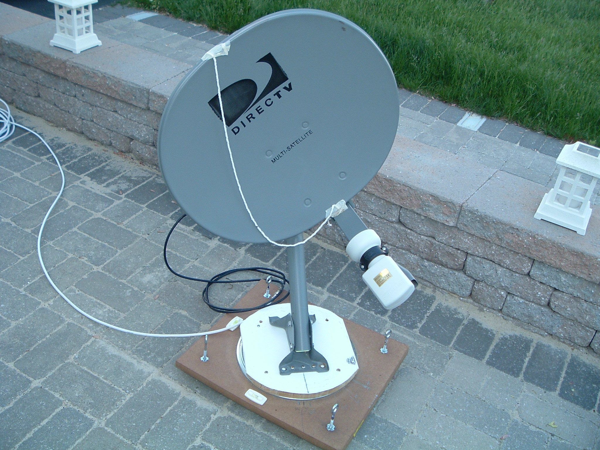

I figured that the original LNBs' were designed for the correct focal point. So I taped a string from the top of the dish to front of the LNB and tape the string to the bottom dish and made a black mark on the string where it touched the face of the original LNB. Now I have the focal point of dish and I don't have to do any fancy measurements. I marked where the new holder will go, drilled hole, mounted the new LNB and adjusted to the black mark with string pulled taut.
I read an article once were a ham radio operator used this method to find a focal point for a dish he was using for a 10 GH transmitter. Great idea, it worked.
The screws and bulb levels are used to level out the board and to use for a finer elevation adjustment, the dish is mounted to board and I have a lazy Susan mounted between the two boards for a finer azimuth adjustment. I have an arrow marked on the front of the board marked south, as long as I point that arrow towards magnetic south from my compass all of the other marking I make for different satellites work. I also have the back elevation and tilt marked for different satellites. I have learned a lot on reading these threads there are a lot of smart guys on this forum.
I usually leave the dish on Galaxy 18 at 123º W and watch the stations that play old movies.
I know you only asked about the string and I made the whole reply long and wordy but I figured you would like to know about my testing dish.

I used the same string technique, to find the focal point for a C-band LNB test on a little Ku dish.
Results weren't good, but at least I knew the LNB was in the right place.
This is the template trick, found on another site.
Here's another way I came up with to locate your LNB at the focal point.

Anole, the brackets look good it beats the $15 dollar plus shipping that I paid for my bracket.

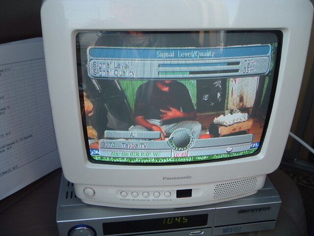

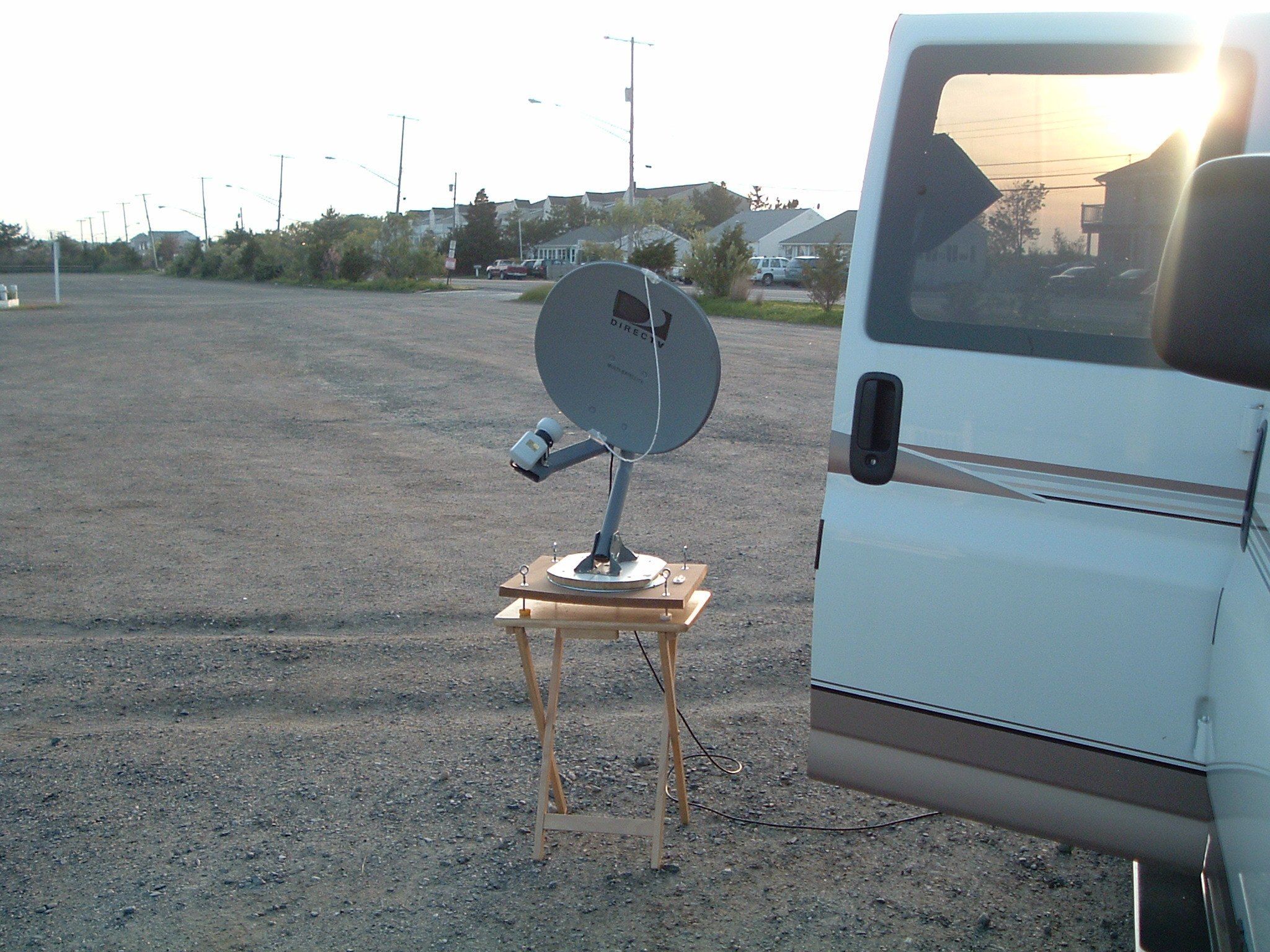

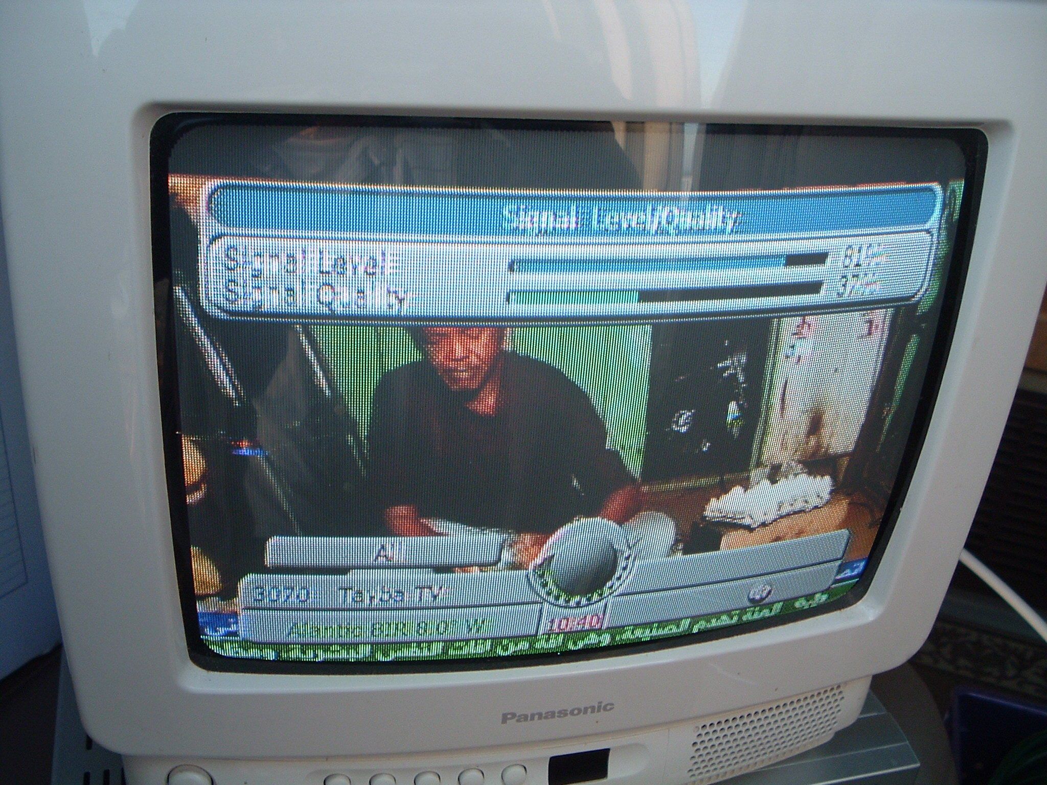

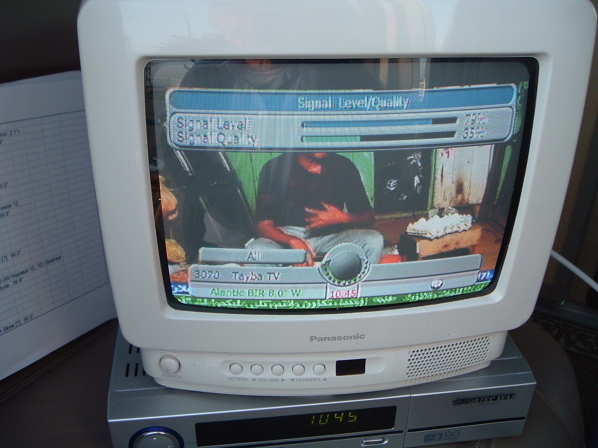

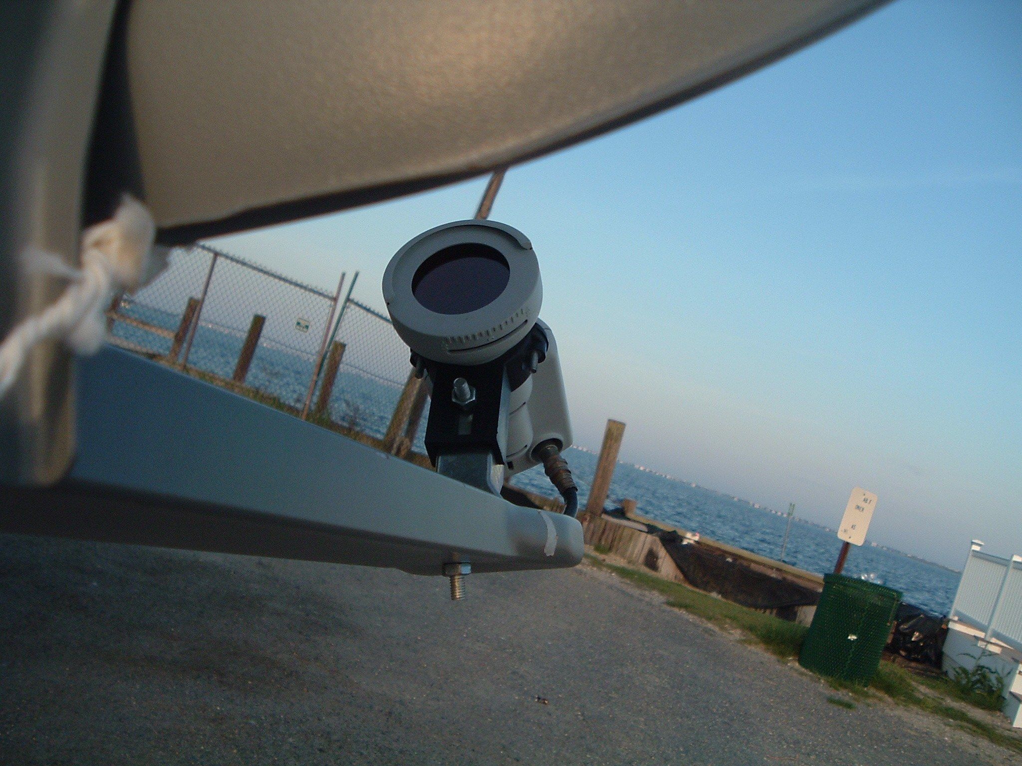

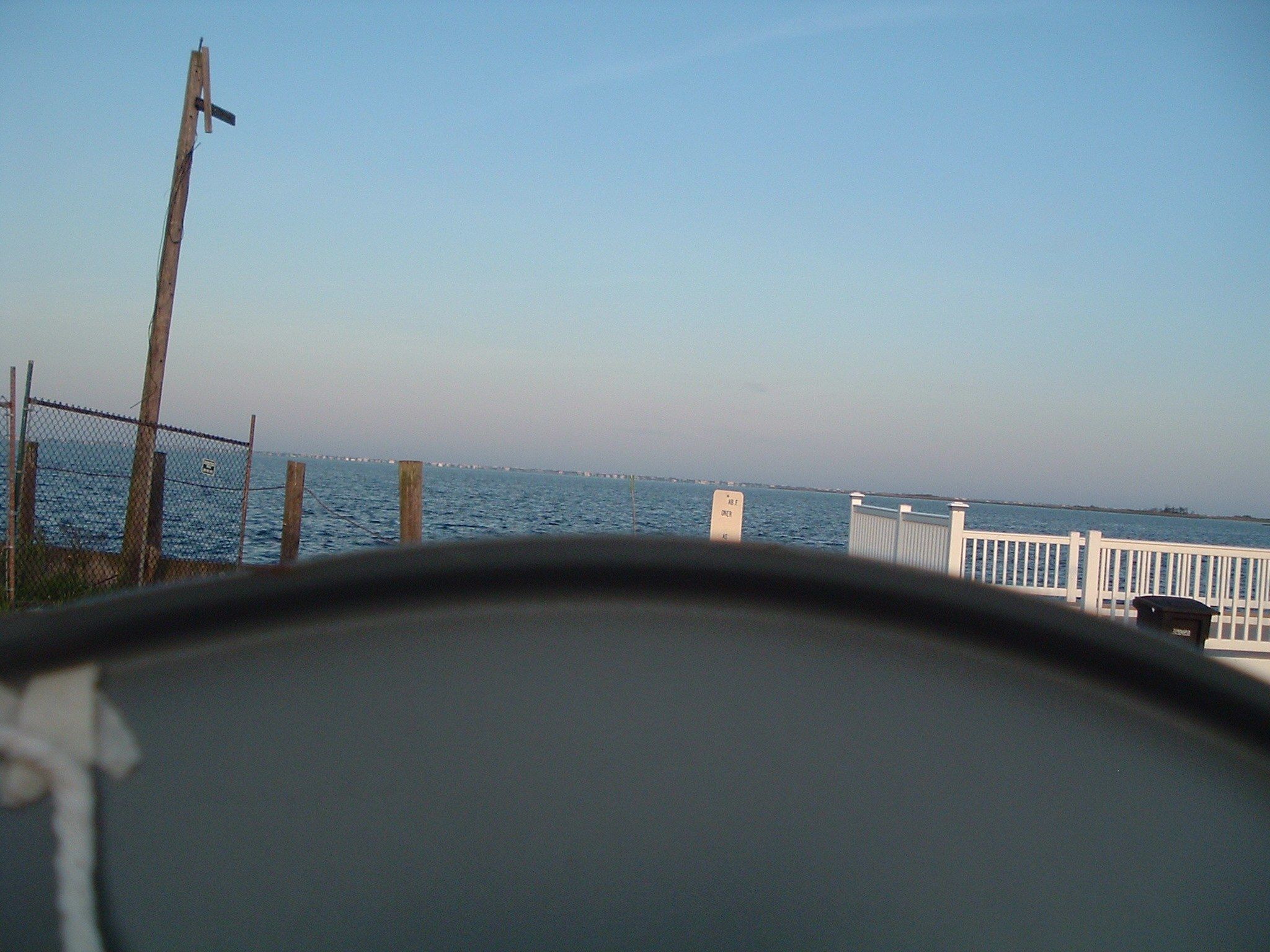

Well guys Atlantic Bird 2 is out there with one transponder, (11500/H/3460) which has two TV stations and one radio station. The elevation is around 9º to 10º and that is pretty low but I managed to locked in the stations around 7:00 EDST, the SQ was not strong and it was going into pixilation at times. This is a really fringe bird and I most likely could not receive a signal from it during daylight hours. Having access to clear shot over the bay certainly helped.
Check out the pics,

Using a larger dish would not be as much fun, as using the old 18 incher!
You sure solved all LOS problems , I've actually thought about doing this at the lakefront now tell me how you're powering the little TV and receiver.
Just something I might be able to pull off on the lake Michigan shoreline , BTW I really do like using my magnetic angle finder on the lnb holder arm , later if I wish to duplicate results I just make sure to calibrate everything using the same angle and bam I'm right on target.
