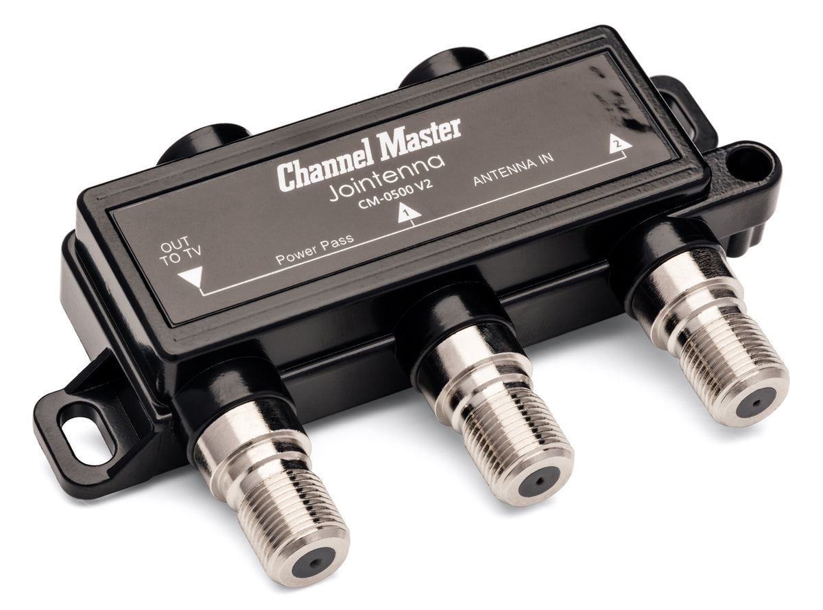

Depends on how you plan to connect the two antennas coax to your system. If you run two separate coax, connect one to your TV and the other to a "tuner", and the tuner to the TV by HDMI, should work without problems. But if you plan to combine the antennas with one coax down lead you may run into a couple of programs. The signal from the original antenna may be weaker depending on how you combine it. And the TV may see the same two freqs as interference and be unwatchable. Unless you can delete one from your channel list. Channel Master sells a combiner you may be interested in.......
More or less spot-on advice. You can also use a network tuner, such as an HD Homerun for one of the antennas. Or even two Hd Homerun's, one for each antenna.
IF you are an advanced person, and REALLY want to do a great system, and you aren't afraid to spend a little money (that'll pay for itself quickly, versus forever payments to a cable company) there's the Televes Avant-X. Which is the only TRUE "Jointenna" type device out there that's NOT hyped, and the best in class.

Generally speaking combiners don't work very well. I have tried many different kinds and you tend to have the same "success" with a backwards splitter.
Try the Televes Avant-X I posted above. Guaranteed to work. It can take 4 antennas, and IF there's two or more on the same RF frequency, it can shift one to another RF frequency. It can also adjust levels, etc.
