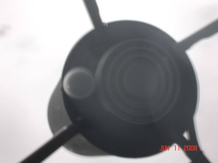

I replaced a CoRotorII with the BSC621-1 and have not seen any change in quality. Then strapped a DirecTV LNB to the Scalar Ring, that gives me the few ITC from the Echo Birds.
When adding the Circular LNB remember to get off the ladder to check quality. The Echo Birds are strong, but they ain't C Band.
I will post a photo when I get a chance, I have a cover on, but you should get the idea.
Here is a Photo showing a Circluar LNB strapped to a scalar ring. Sorry it's so blurry, but shot it thru the mesh.
oh ok. That is about where I put my Ku lnbf. I was orignally going to get the BSC621 but people said they had trouble getting a Ku signal so I ditched that idea.
