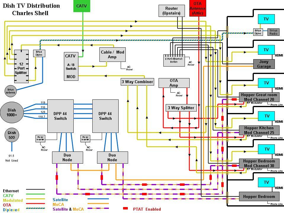

Are there any restrictions on what can be enabled for more than two Hoppers? Here is a wiring diagram of my system. The only Joey is linked to the Great room Hopper. Two Hoppers have PTAT turned off and the other two Hoppers have PTAT turned on and the AutoHop works on both except for the one day.
