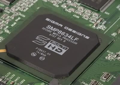

AZBox proc - Sigma Designs SMP 8634 - makes it very attractive to direct any video content processing through it for watching on HDTV, since it has advanced multi-format decoding, video scaling and color correction capabilities that many DVD Players' and older HDTVs' procs simply don't.
However, this Sigma Designs Support's citation may explain lack of the Dual DVB-S/S2 Tuner offer for AZBox:
"Q - Does SMP8634 supports two H264 HD contents decoding?
A - We do not support two HD decoding of H264 (two of the files are using 1080) because it will run out of memory bandwidth. If you use one sd 720p and one 1080i, it will be ok."
Attached HDTV STB Development Kit from Sigma Designs may explain where these dummy AZBox menus came from. They're still waiting to be supported by extra code from the devs team.
