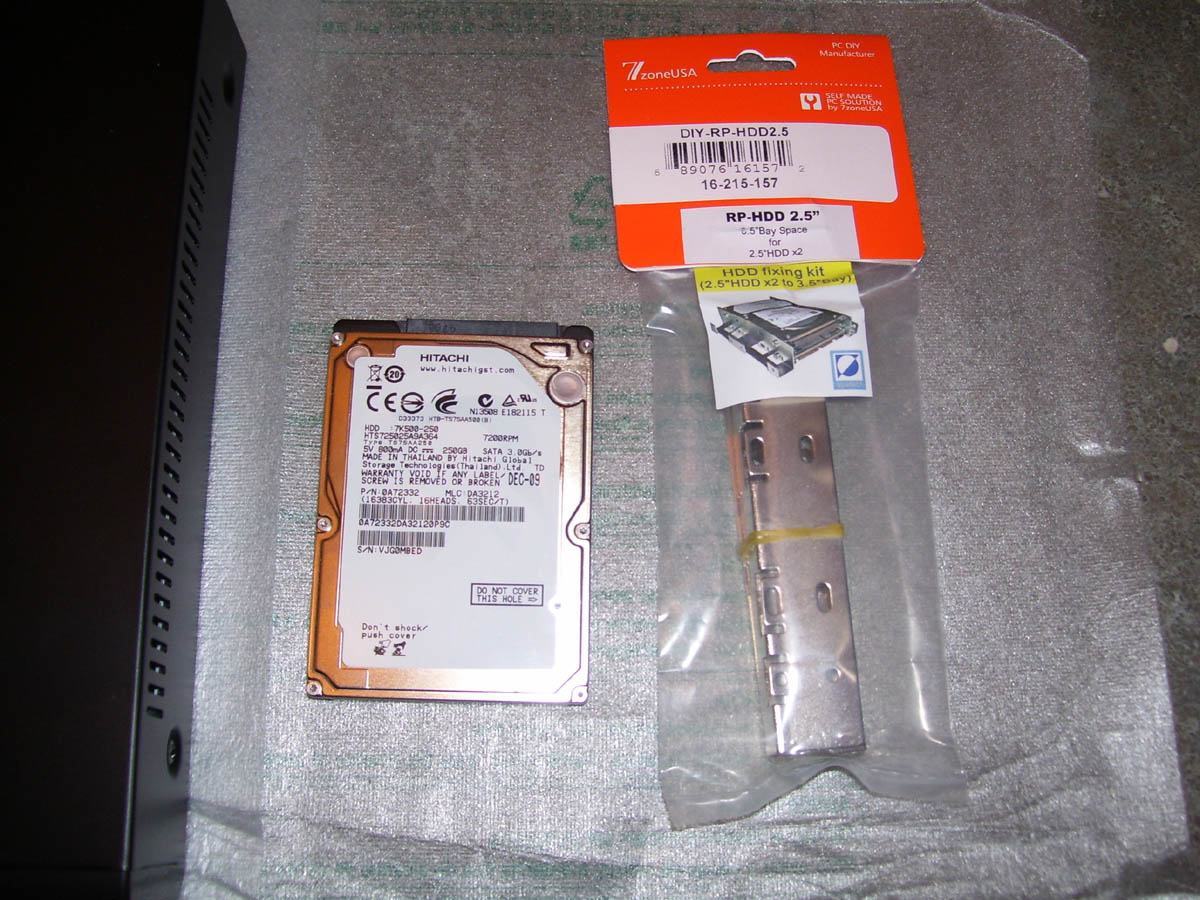

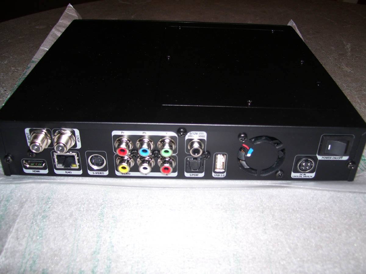

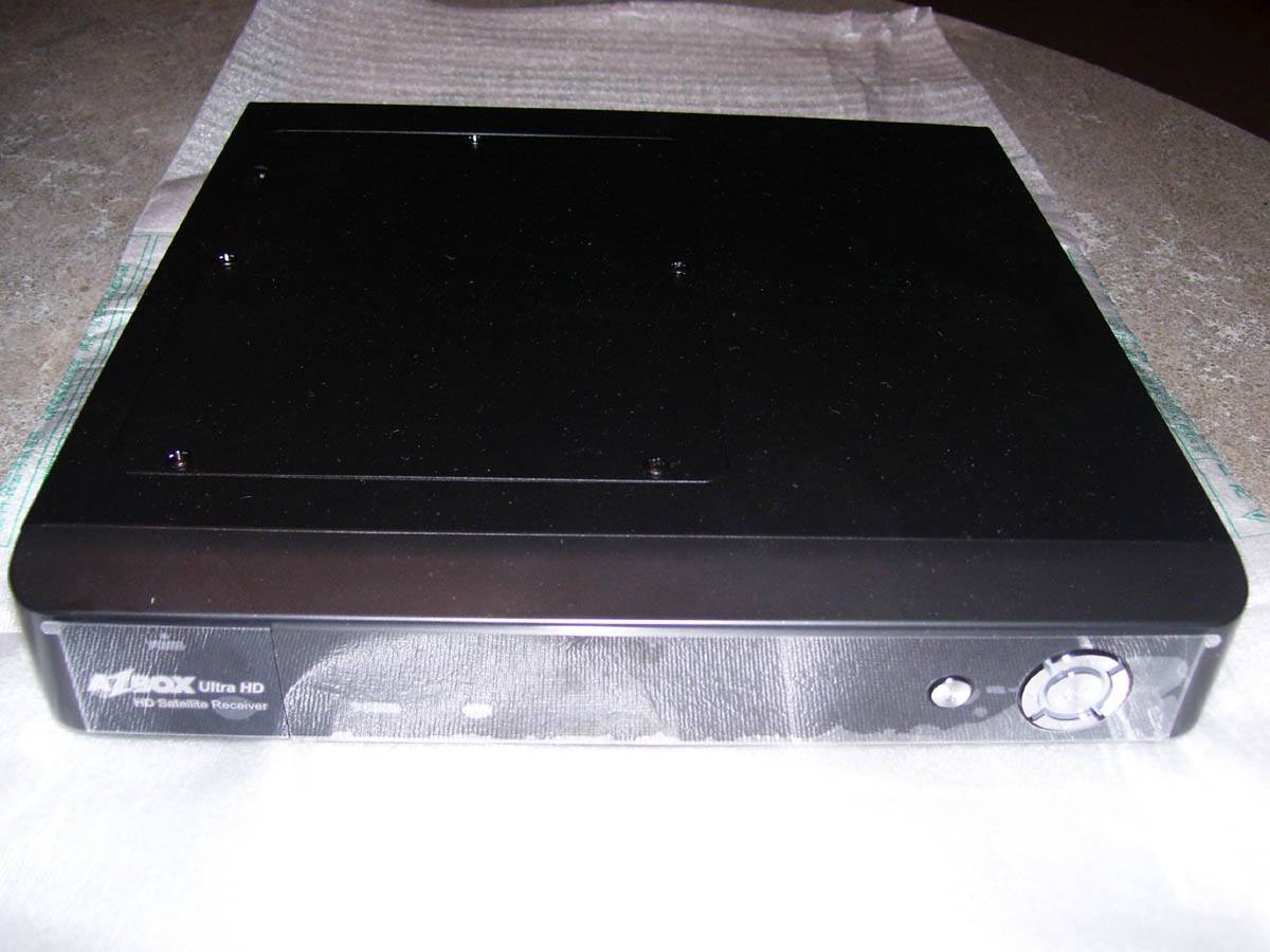

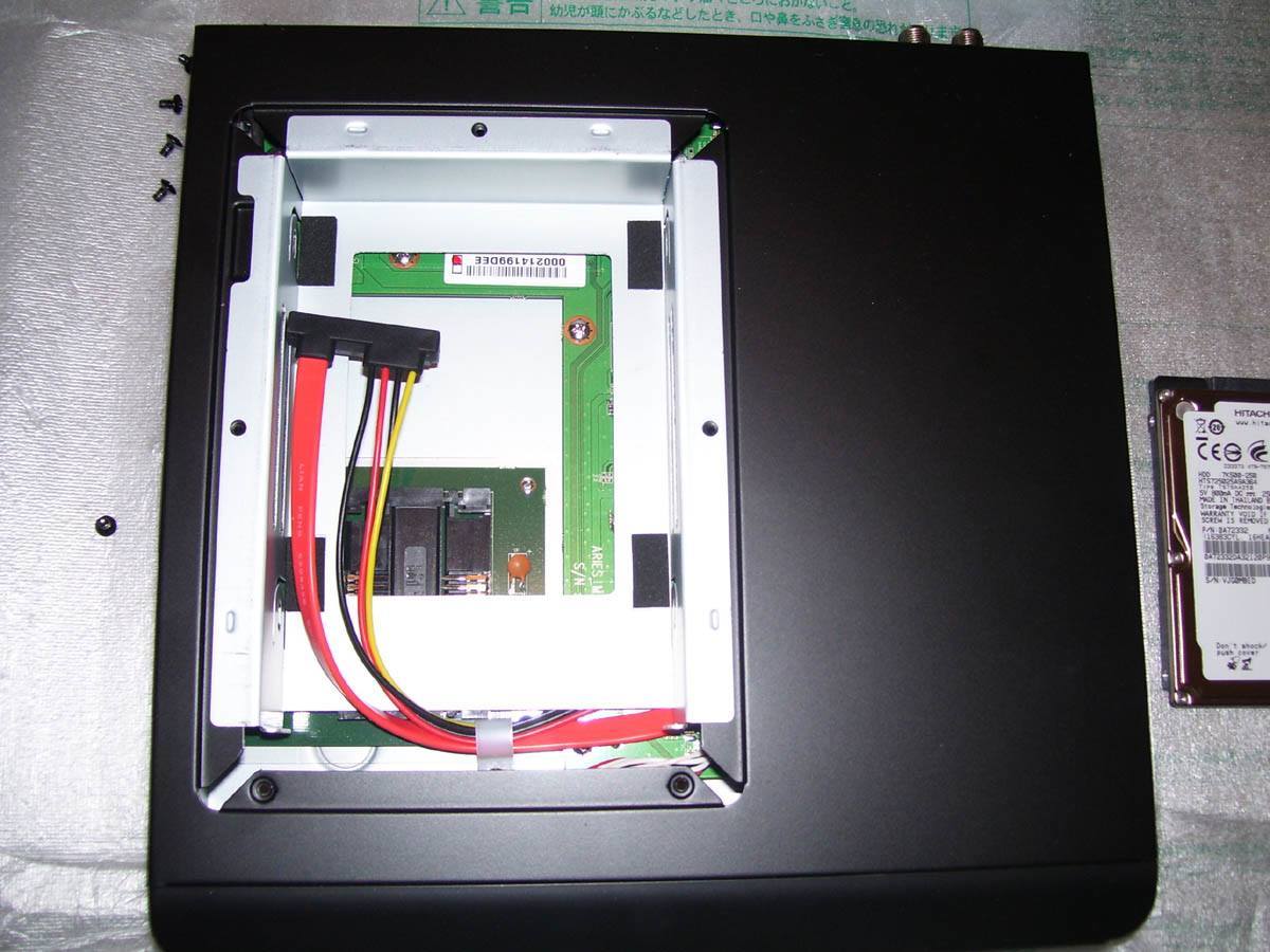

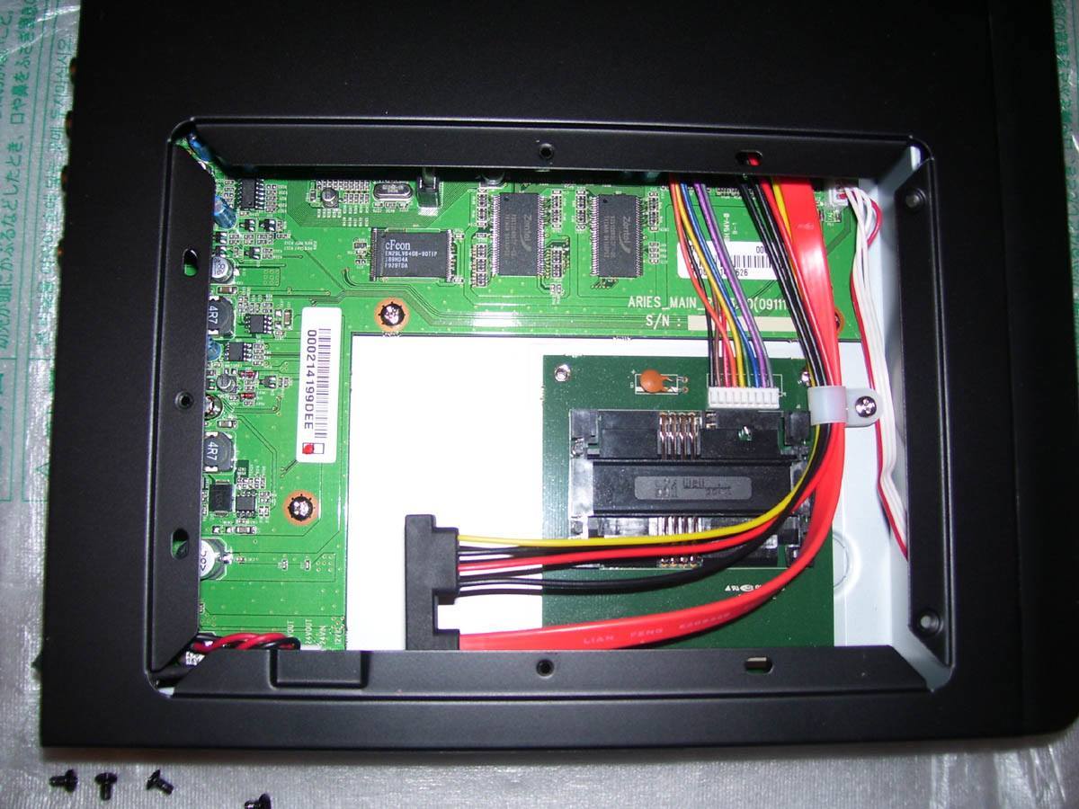

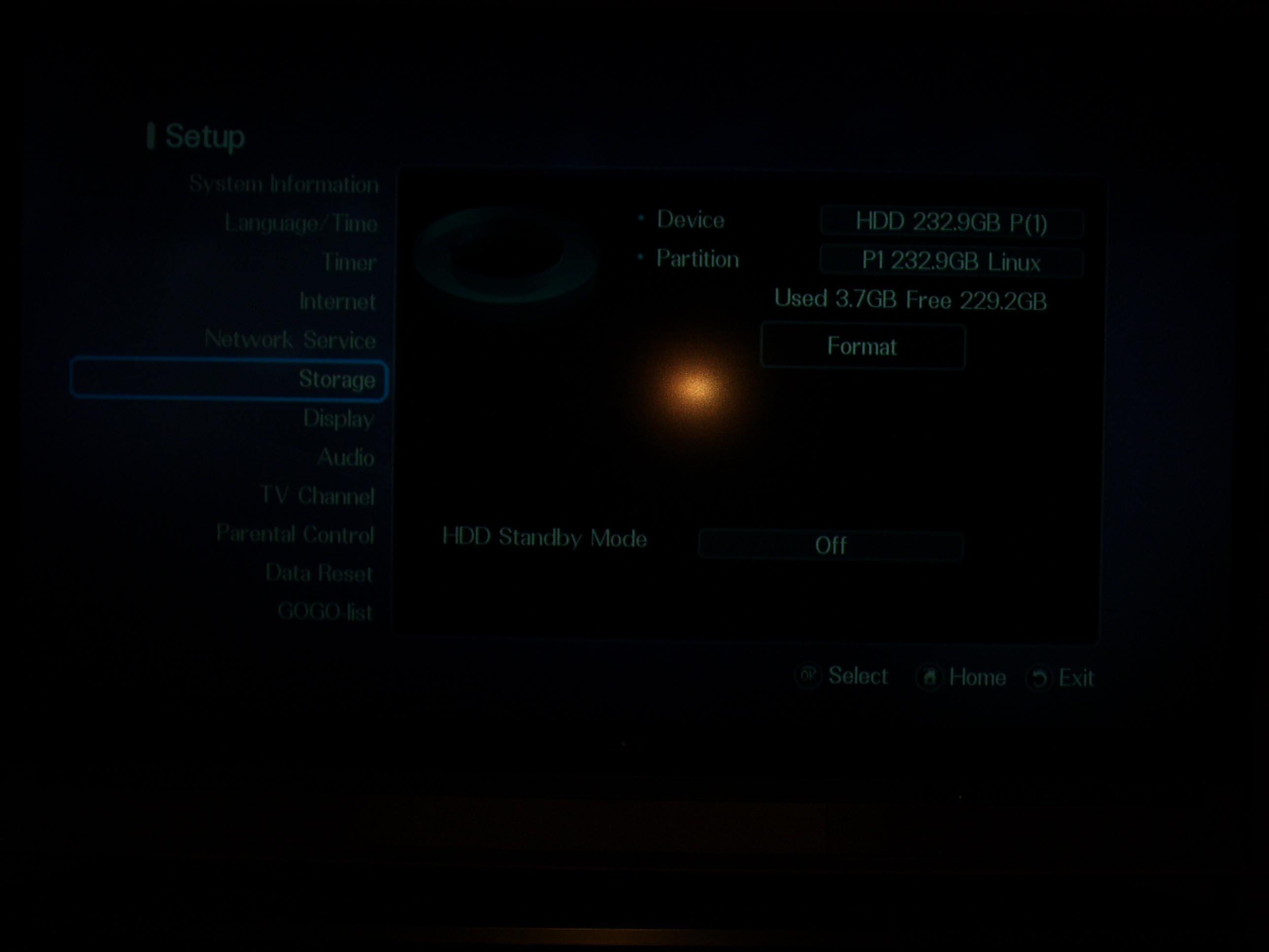

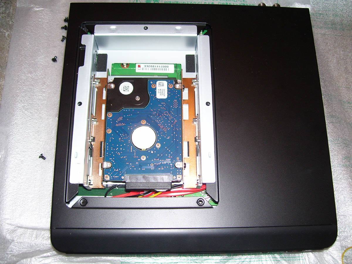

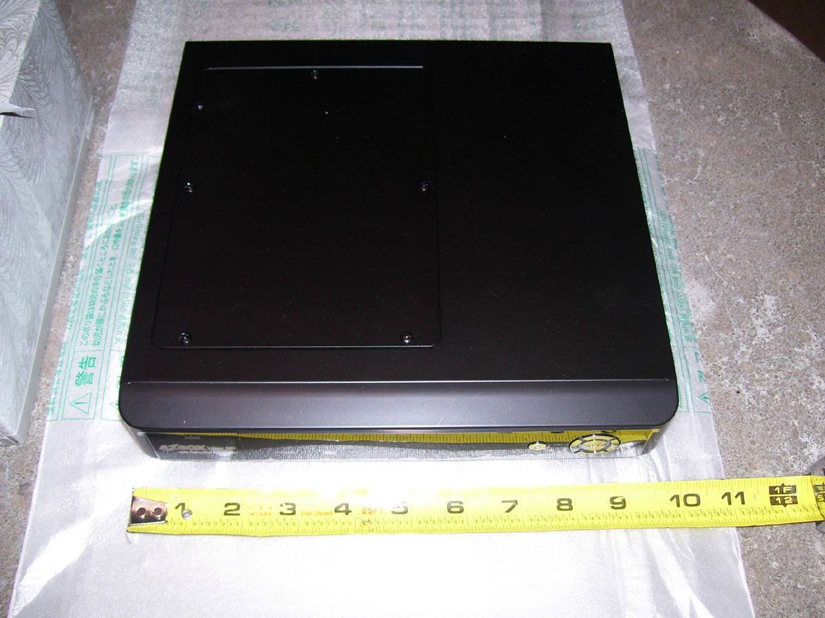

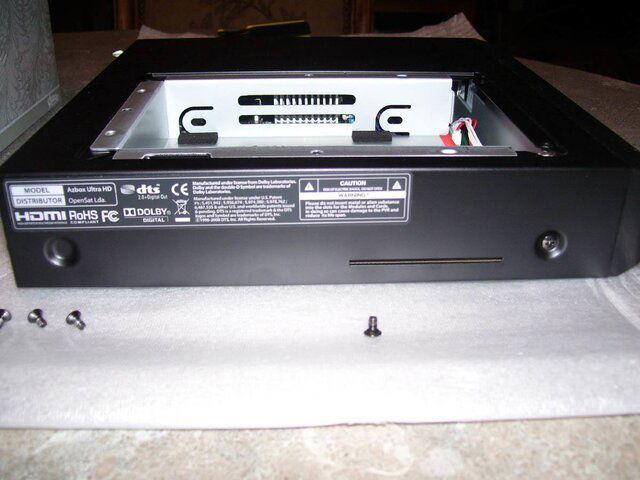

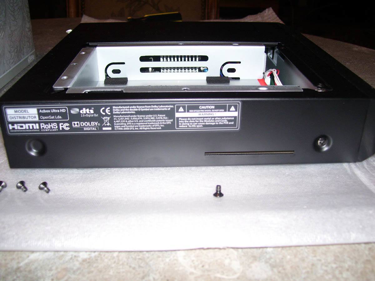

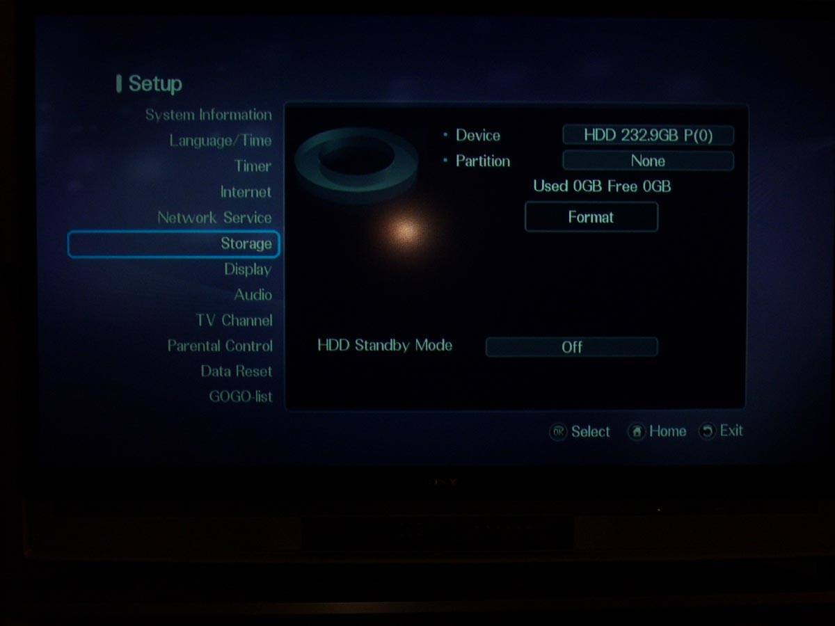

There are already a couple of threads discussing the Ultra and I don't have time for a formal review but I did take some pictures which I thought might be of interest. While the Ultra (like the Premium +) currently have some issues, I'm optimistic they will be addressed by firmware and I will (hopefully) have a box that can do S2, 4:2:2 and has hardware blindscan. pics are from installation of hard drive. Its designed for easy installation of a desktop drive. I happen to have a 250GB 7200rpm laptop drive that wasn't being used so it worked out well. I would have liked to have seen them vent rear of the hard drive bracket adjacent to where the fan is to blow air directl over the drive but that is something you could do yourself if so inclined by drilling a few holes and filing. They did include a card slot which is accessed on the side. once drive is installed, formatting was painless although my HDMI connection did go dark during the format. I connected a composite cable and was able to watch as it was formatted. when completed it reboots and thats it. haven't tried recording anything yet, maybe tommorow.

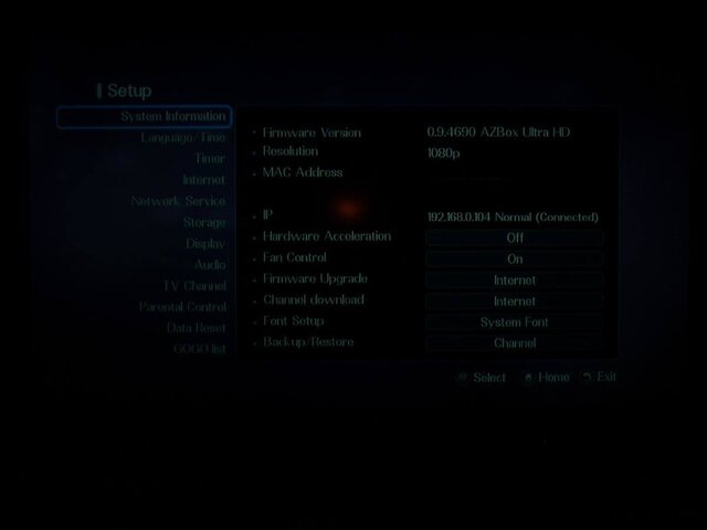

In the 4th and 5th pictures showing the unit with the top removed, you can see the combo sata/power cable. The drive I installed was unformatted and I included screen shots before and after the format.
Thanks - I thought that looked like a sata connection. I couldn't interpret the details on the screen shots too well.
I agree, screen shots are pretty dark but the best I could do. You are clicking on the thumbnails and not trying to see the little pictures right?
Mr3p >Thanks for sharing those pix. I am guessing the fan is extracting but the casing shows no inlet vents, are there any on the base? My concern is AZ box processors run quite hot.
Does the card slot on the side count as an inlet? ;) Everything is temporarily disconnected as I'm in the middle of rewiring but I didn't notice the box generating a lot of heat. After everything is setup again, I'll put my hand on it after its been running for a while and let you know. My box probaby will run a little cooler as I used a laptop drive.
