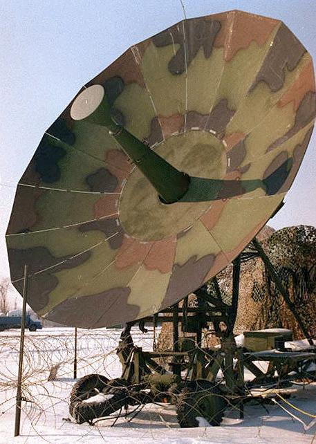

In the marines, we dropped 5 8 foot rods for our satellites, they were all wired together, plus we dug a pit for them and dumped in bags of rock salt. On the 20 footer, the ground wire was huge because there is a lighting arrestor at the top of the thing. Here is a REAL satellite dish.
