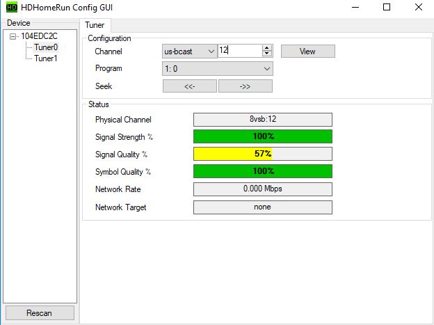

Here are the downtown antenna results for KSQA from both antennas, with preamp:
KSQA-12 on rabbit ears:
KSQA-12 with mudflap

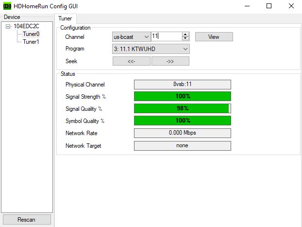

KTWU on the mudflap, downtown:

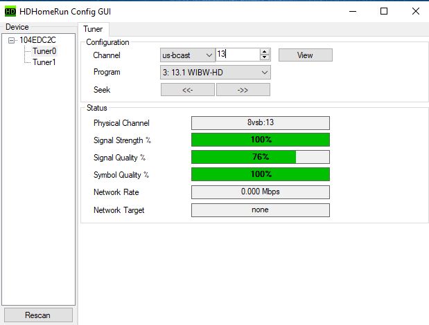

WIBW on the mudflap, downtown:
