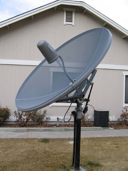

It is six feet in diameter.
Note: I'm definitely going to have to take the dish apart and put it back together. I think the panels became uneven after the wind knocked it over :|
That's a cool looking dish! At 6 feet, its larger than a microbud, but not overly obtrusive. Great deal! Let us know how well it receives DVB C-band.
Tron: I'm using it for Ku band. 0_o I plan on using the Extreme II LNBf.
